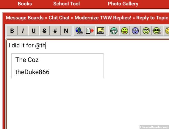

Here is a tampermonkey script to make @ users easier with quote inserts, had to break it into two posts:
Mentions (@username):
When you type @ in a text box (with class post-box), it shows a quick list of matching usernames.
Quote Insertion (\q):
Whenever you type \q, the script automatically replaces it with TWW Quote Tags.
Start copying into tampermokey below:

// Handler for input (detecting \q, or building @ mention)
function onInput(e) {
const ta = e.target;
activeTextArea = ta;
const value = ta.value;
const pos = ta.selectionStart;
// 1. Check if we just typed "\q"
// If the user typed \q (two chars), we see if the text before the cursor ends with '\q'.
if (value.substring(pos - 2, pos) === '\\q') {
// Replace it with
, place caret
insertQuote();
hideSuggestions();
return;
// 2. Check if we are in an '@mention' scenario
// Find the last '@' before the cursor (if any)
let lastAtPos = value.lastIndexOf('@', pos - 1);
if (lastAtPos === -1) {
hideSuggestions();
return;
// Make sure there's a space or line start before '@' or it is indeed a new mention
// (Otherwise, it could be in the middle of text not intended as mention)
// But for simplicity, let's skip that check and assume any "@" is a mention attempt.
// The text typed since '@'
const typedSinceAt = value.substring(lastAtPos + 1, pos);
// If typedSinceAt includes a space or bracket, it means user ended mention
if (/\s|\[|\]/.test(typedSinceAt)) {
hideSuggestions();
return;
// We have a partial mention
mentionStartPos = lastAtPos; // store for insertion
const partial = typedSinceAt.trim();
if (!partial) {
// user just typed "@", so show entire list maybe
currentSuggestions = USERS.slice(0, 15); // limit results
} else {
// do fuzzy search
currentSuggestions = findMatches(partial).slice(0, 15);
if (currentSuggestions.length > 0) {
showSuggestions(currentSuggestions);
positionSuggestionBox();
} else {
hideSuggestions();
// Attach event listeners to any textarea with class "post-box" that appears
function attachToPostBoxes() {
const postBoxes = document.querySelectorAll('textarea.post-box');
postBoxes.forEach(box => {
if (!box.dataset.twwListener) {
box.addEventListener('input', onInput);
box.addEventListener('keydown', onKeyDown);
box.dataset.twwListener = "true";
// Run once on load
attachToPostBoxes();
// If the site dynamically loads new textareas, we can watch for DOM changes
const observer = new MutationObserver(() => {
observer.observe(document.body, { childList: true, subtree: true });
1/23/2025 10:51:20 AM

I did it for The Coz!
