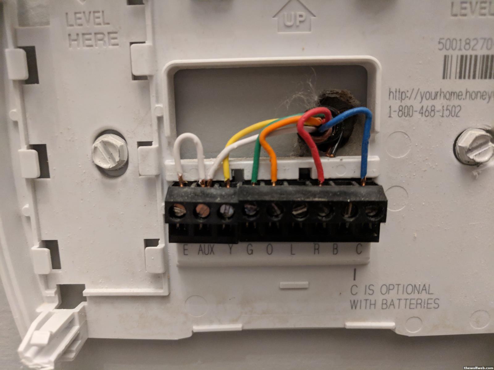

darkone
11627 Posts

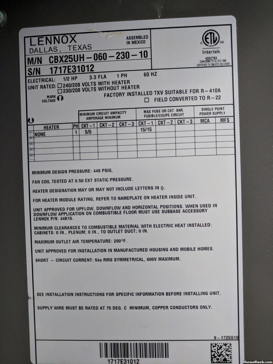

What kind of HVAC unit do you have? Post the make and model. Do you have an emergency heat switch anywhere?
1/31/2019 6:09:56 PM
darkone
11627 Posts
Post a pic of the thermostat wiring too.
1/31/2019 6:12:15 PM

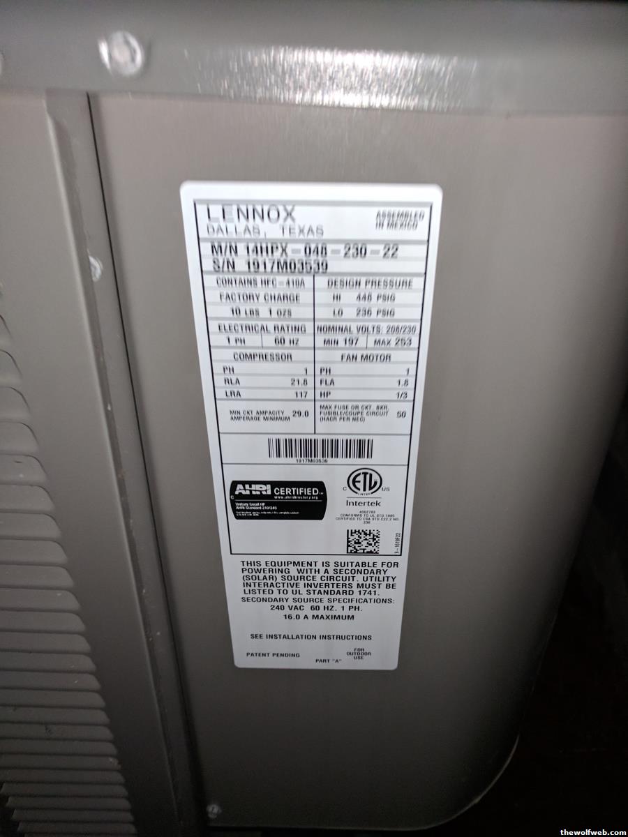

Go take and post a photo of the tag on the outside unit so that we can see the model number. You might just have straight electric heat. RIP your wallet if true.

mildew
Drunk yet Orderly
14177 Posts
2/6/2019 12:16:10 PM

Post the label for the outside unit too.

mildew
Drunk yet Orderly
14177 Posts
Outside unit
2/6/2019 6:32:09 PM
mildew
Drunk yet Orderly
14177 Posts
Downstairs therm
2/6/2019 6:41:13 PM
A Tanzarian
drip drip boom
10996 Posts
One of those wires is not like the others.
Someone else will have to say whether or not that's significant.
2/6/2019 9:30:37 PM
darkone
11627 Posts
If you were to disconnect that white wire from the thermostat and set your heat to run, just the heat-pump should run (It should do that anyway). Make sure you set your thermostat is set to heat and not emergency heat. The E and Aux are bridged, but I think that's ok. They both trigger the electric heat.
Run through the system setup on page 8 of the thermostat manual. Make sure it's set for heat pump on Aux heat and electric heat on emergency heat.
I noted that you seem to have a zoning kit. That makes all of your controls way more complex.
If the heat pump won't run by itself, you have a problem and need it addressed.
The label on the air handler says no heater is installed, but you can add the heat strips as supplementary kits so that doesn't mean there aren't electric heat strips in there. What's the breaker size? I would expect 30Amps or more.
