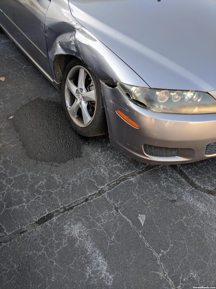

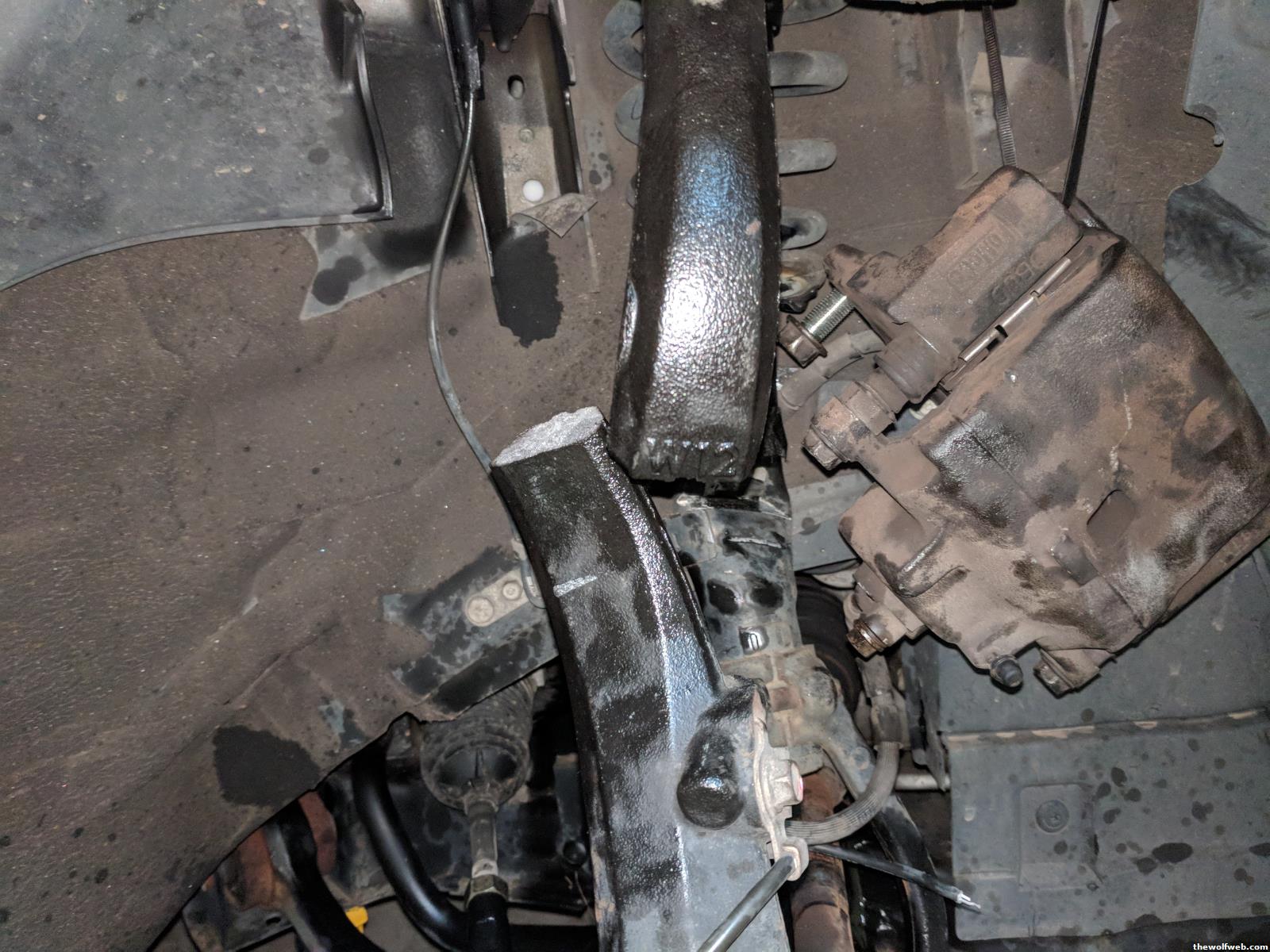

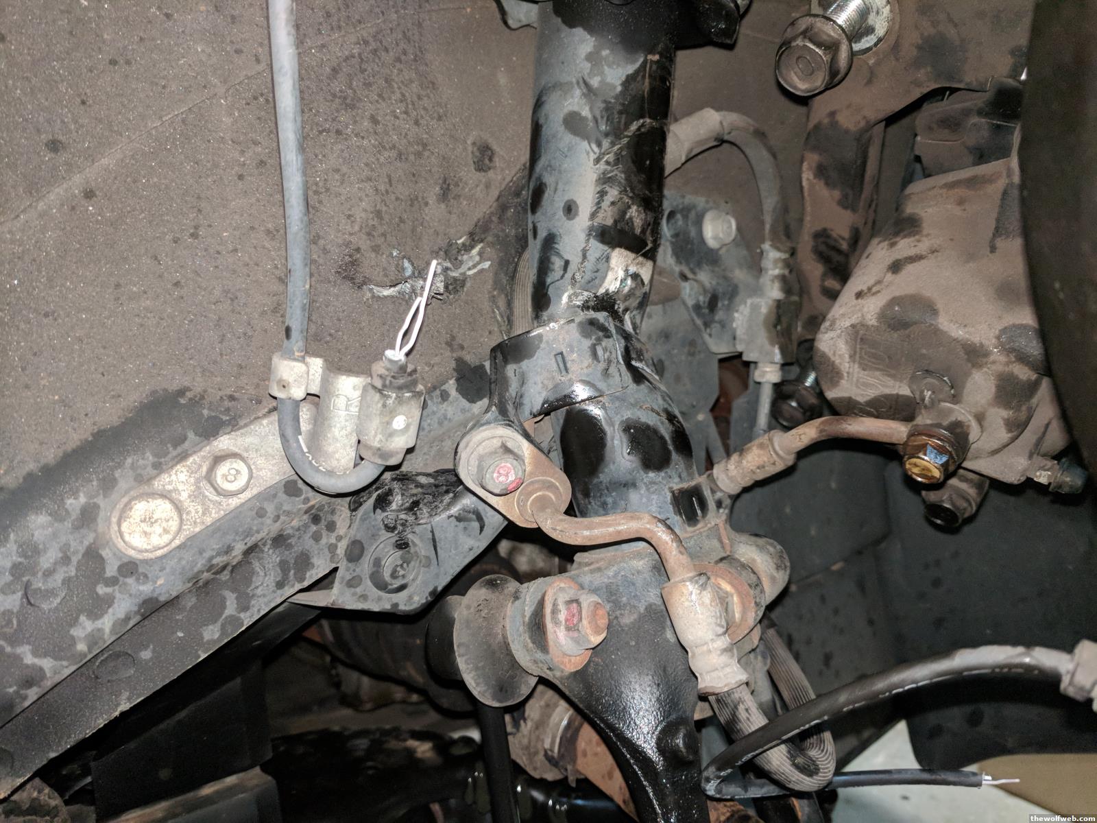

Gonna find out if it's worth fixing this.
Looks like the knuckle, strut and inner CV boot as well as a few ball joint boots are toast and obviously quarter panel.

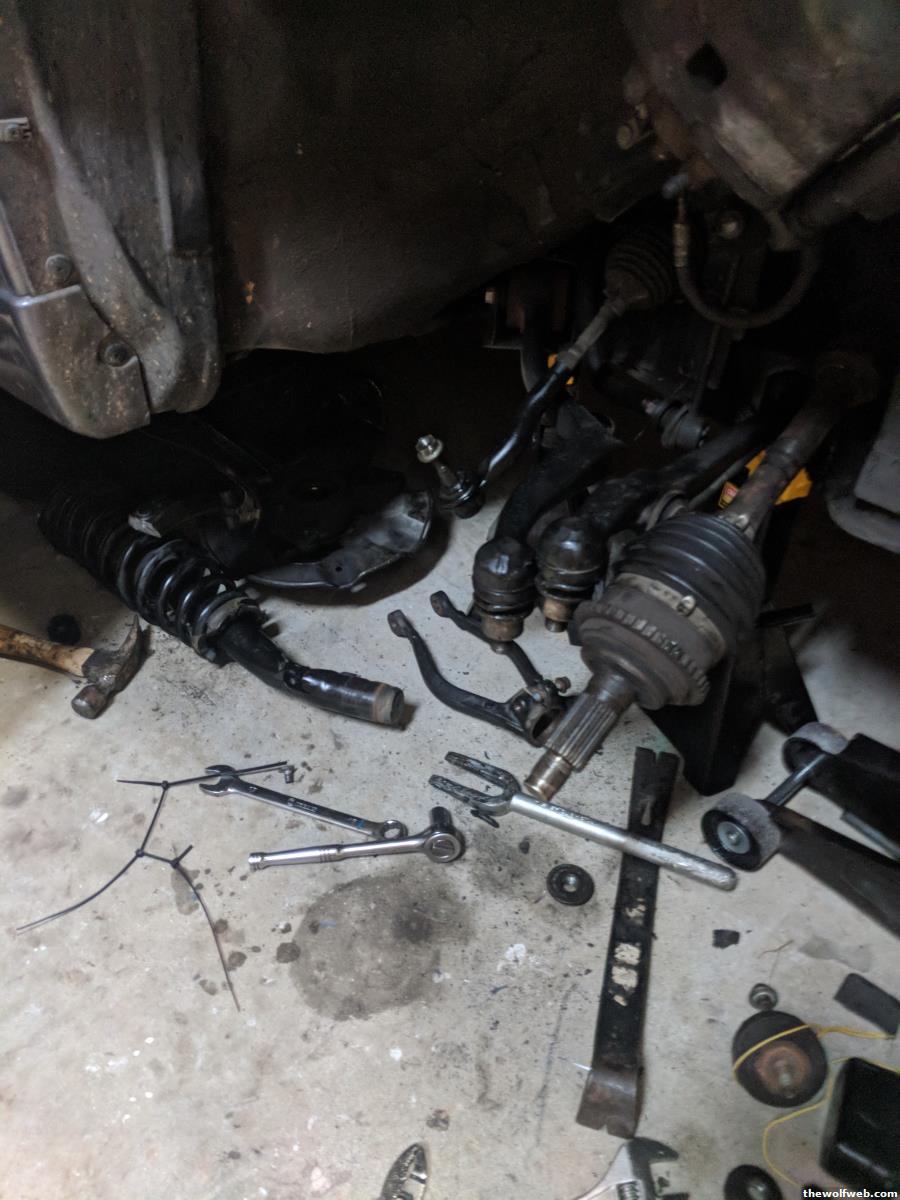

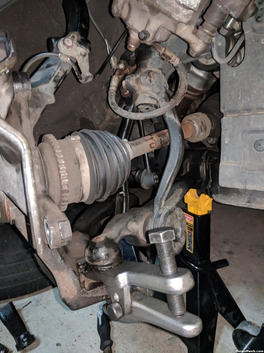

I have bottomed out these pickle forks and the lower arm ball joints still won't free

https://www.lkqpickyourpart.com/locations/LKQ_Pick_Your_Part_-_Raleigh-168/recents/
Pick and pull what you need and keep on rolling. Depending on how you feel about the rest of the car (do you feel it'll last you a few more years, etc), it may be worth just making the ~$300 investment to get it derivable again... Maybe. There's still a lot of variables to consider...

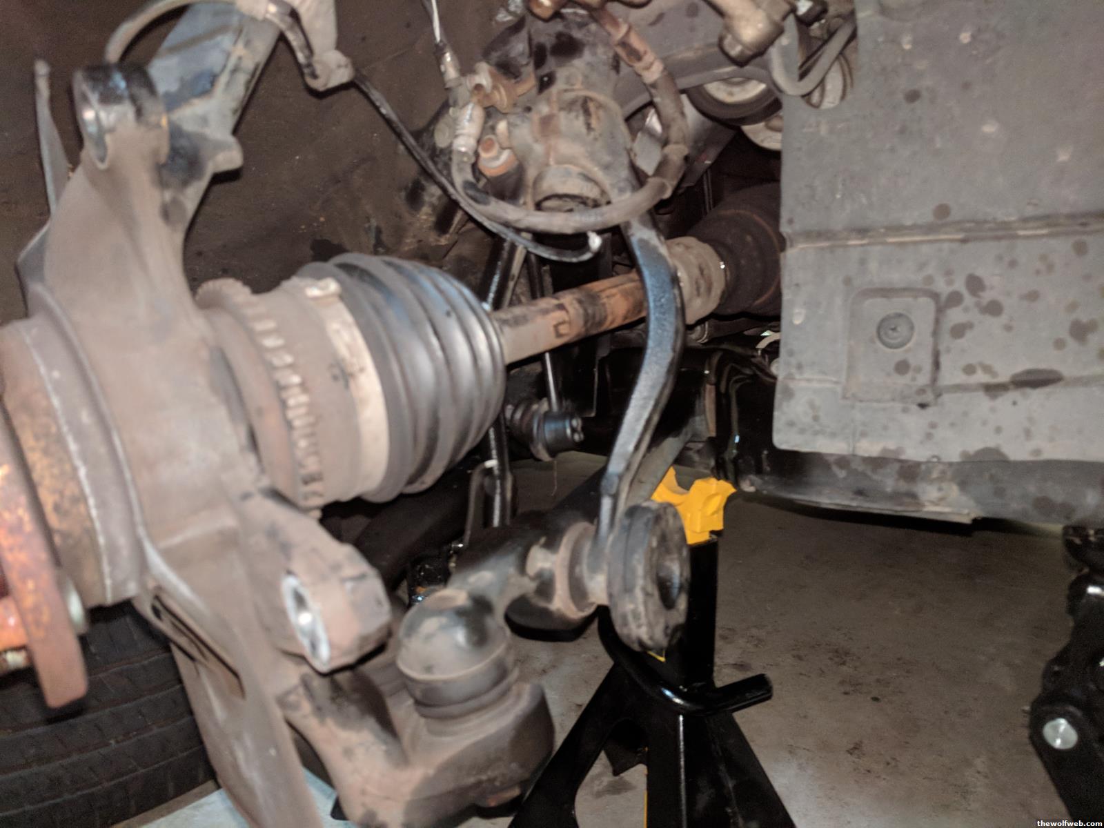

PaulISdead
8977 Posts
I was just going to use it to get back and forth from work and keep miles off my truck. She is gonna get a new car regardless. If I have to work this hard at a junk yard the parts will need to be cheap.

PaulISdead
8977 Posts

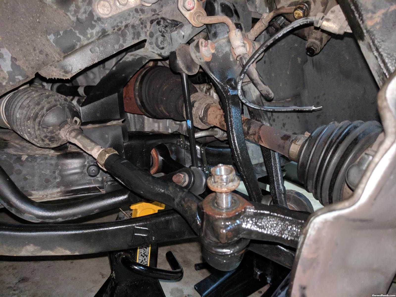

i got that nut almost to the hilt and all it gave me was some threads to file down when it shot off

35667 Posts
that jackstand makes me nervous as hell
12/3/2017 8:00:47 PM
PaulISdead
8977 Posts
Meh there is another one just a bit further down and the jack

PaulISdead
8977 Posts
Heat and beat

35667 Posts
i don't trust folks who work on cars with claw hammers

PaulISdead
8977 Posts
I should have used two 4 lb sledgehammer to hit both sides at the same time. Since I only have one I guess you shouldn't let me work on your car.

PaulISdead
8977 Posts
Got it rolling again
