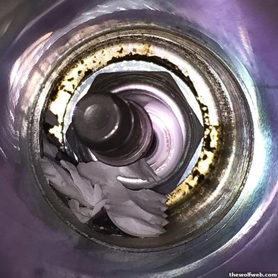

There's a lot on the net about spark plugs insulators that have broken off inside the cylider...but I broke the insulator on the outside of the cylinder.
I was replacing my plugs and the rearmost one had tight working space. I was having a very difficult time getting my torque wrench on the extension, so I tried combinations of different extensions to get enough space for the wrench. I finally got the wrench in, turned it a little, and it felt and sounded funny. I pulled the extension out and realized I forgot the fucking socket.
I think what happened was the extension got jammed next to the plug terminal. When I cranked on the extension it probably pushed the terminal to the side resulting in a shattered insulator. So...now I have shards of ceramic insulator in whatever you call the hole where the spark plug goes.
I'm asking for advice on how to proceed before I further fubar my shit. I'm thinking I should vacuum out the hole, unscrew the plug, hope there's enough insulator for my socket to hold the plug as I pull it out, then hope none of the ceramic falls in.

Sounds like you're on the right track. Im not sure if a shop-vac would produce enough suction to lift the pieces out from down in there, if not try compressed air to blow them out(watch your eyes).

Maybe put the shop vac on into the big end of a funnel and stick the small end of the funnel into the hole?

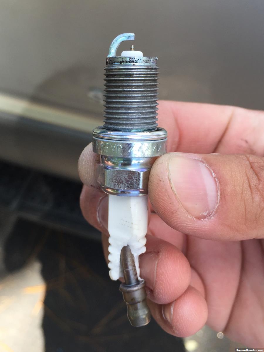

I duct taped a fat silicon straw to a vacuum and sucked most of it out. Two little fragments wouldn't come out so I finally took the risk and pulled the plug. The plug was fine on the cylinder side. I stuck the straw back in and sucked up the two remaining pieces. Truck seems to run fine now.

should have tried air blowing into the hole before that risky move but glad you got it
