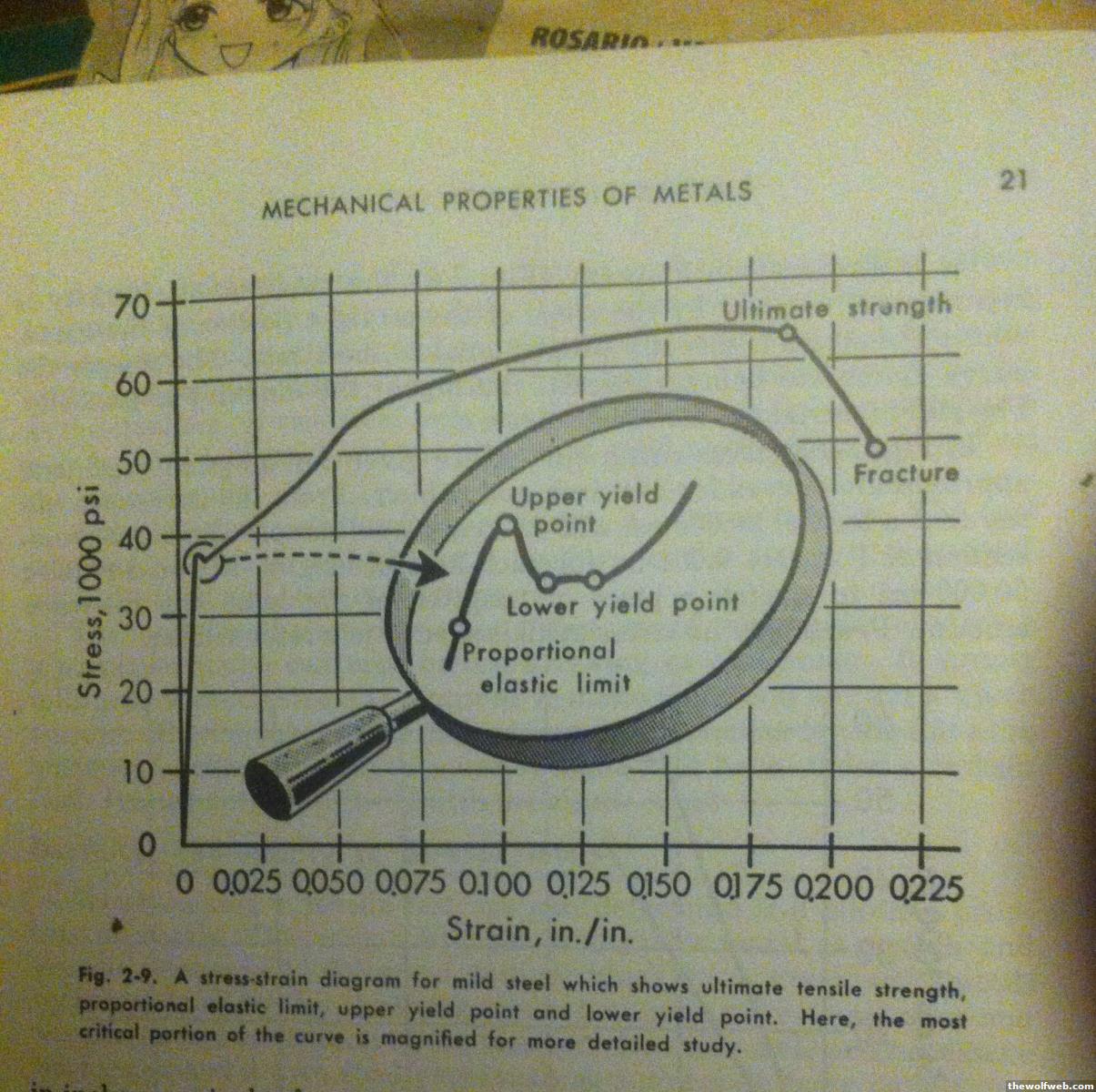

Fermat
47007 Posts
Ok let me give this a shot. Mods: please forgive me if I double-post. I am old now, as are you and need time absorb the booze that keeps us alive.
My question is, more precicely, what is it about the carbon content of mild steel that grants it this "grace" period in the the stress/strain graph.
More important to me, it appears, is what the significance of the lower yield point followed by necking?
I am reading a VERY old book. It is not described past "this is important" as the graphic will show.
What is it about the carbon content, physically, that makes this an impossibility in other ferrous metals?
9/16/2016 1:19:20 AM

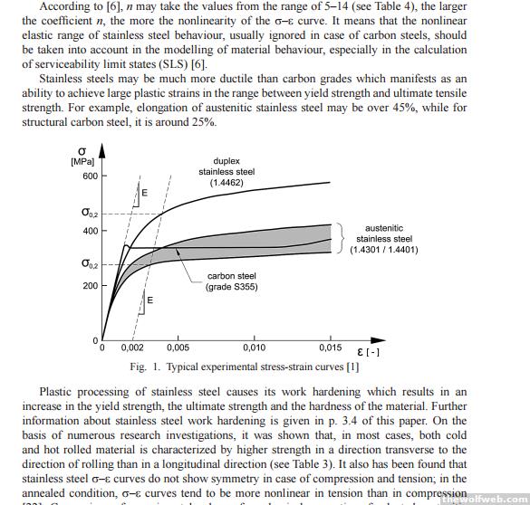

Fermat
47007 Posts
Here is another with more emphasis put on stainless steel and how it elongates in comparison to duplex and low hydrogen steels.
Chemically I have no clue. But on a rudimentary level I can see how lower carbon mild steel might behave the way it does.
Maybe there isn't enough carbon to construct regular cementite boundries to break all at once and so it behaves less like a single material and more like, say, a "rope" constructed of glass filaments with high modules of elasticity with the rest of the rope being made of, say, rubber.
The strain is super low till the glass fibers break, at which point the rubber strands just stretch through the rest of it's "plastic" phase till ultimate failure.
Reckon it has any salt to it?
