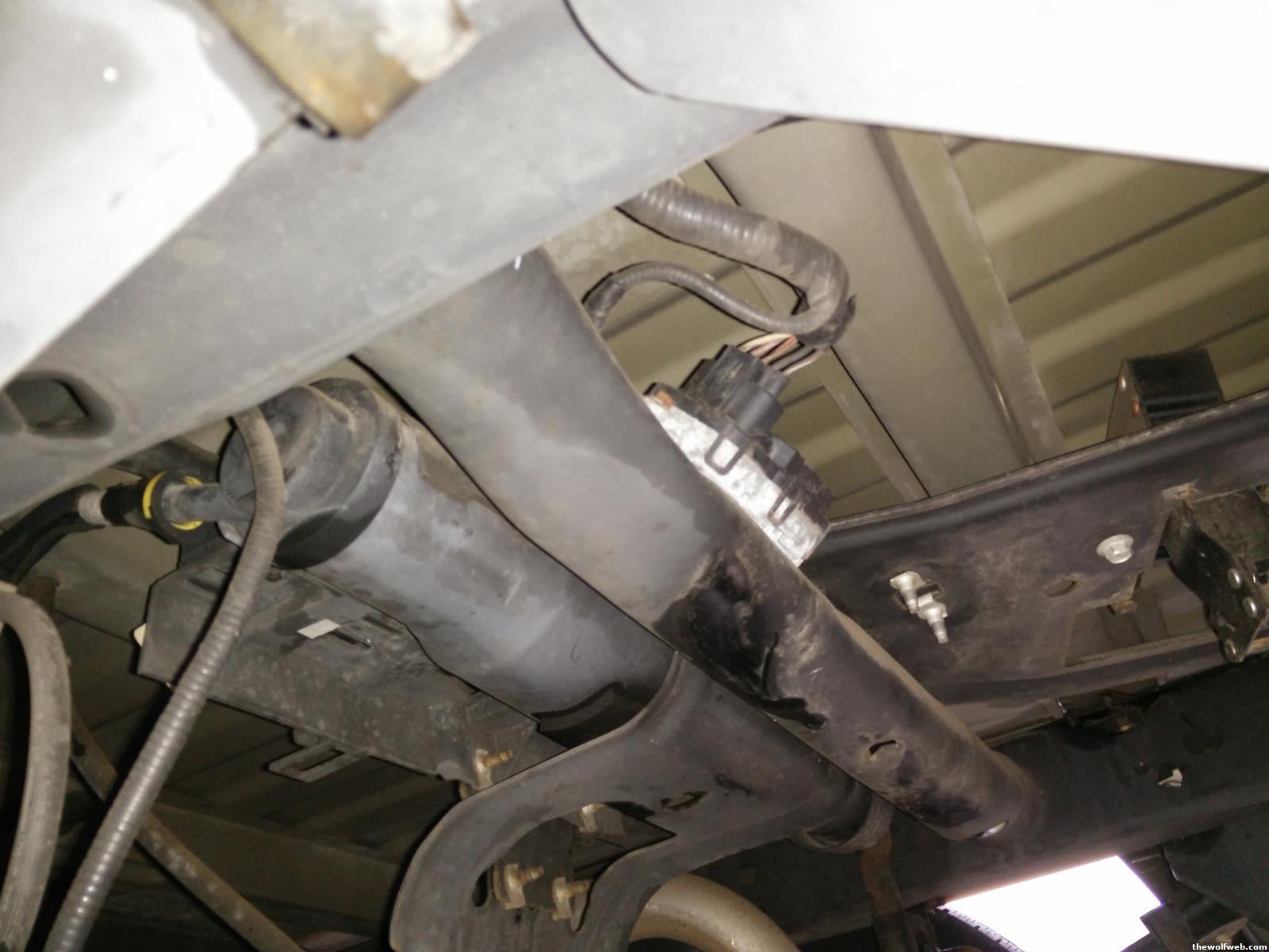

2005 F150 5.4L 76k. If the car sits for more than 30 min, it will have a start that seems starved of fuel. I'll give it time for the pump to prime before cranking but no change. Id seen it once every several months but now its every time. Idle is smooth.

i dont know why i added "on second crank" i just meant the starter motor and load seems normal. it seems like it takes 1-2 seconds to get the right amount of fuel into the cyclinders. like there is just enough to not turn over fully. but its golden on the second try. my guess was fuel delivery as well but its only on the start. wouldnt a bad fuel pump idle poorly and see other issues?

Internet says a lot of fuel gremlins due to corroded fuel pump driver mine looks like a good candidate for replacing

that sounds very plausible to me
