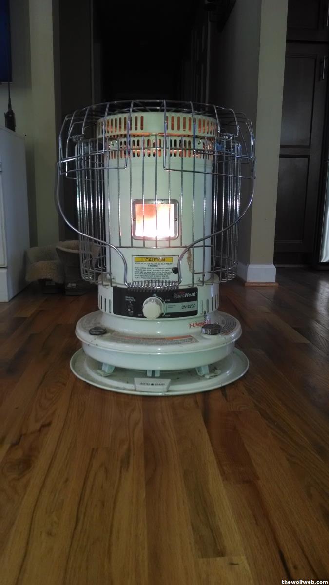

"Flue gas condensation maybe? I've heard on the high efficiency furnaces this can be an issue (less heat lost out the flue)."
This is it, its a widely known issue now. The problem is Lennox redesigned the part that was causing the condensate to back up, but did not issue a recall or service bulletin so the tech was left to figure it out on his own over multiple trips.
The whole winter was hell. I survived using this, despite having one of their "best" furnaces.
