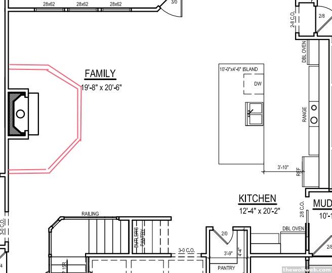

My wife and I are designing a floorplan and she is basically requiring that the tv go over the fireplace.
I like the look of this, but do not like it when the tv is too high up causing neck strain.
I'm currently looking for solutions to this, does anyone have any advice
Here is our floorplan:
Here is a picture I came across that may be a good option, with a relatively low viewing angle:
Any advice appreciated

keep the mantle low, or get a bracket that you can pull the tv out and down
be careful of heat

I agree with a low mantle; could you do a stepped floor to lower the chimney area? If you're going wood burning, the low area around the chimney could be stone to help prevent fires. Those screens don't catch everything and those front aprons aren't long enough

"I agree with a low mantle; could you do a stepped floor to lower the chimney area? If you're going wood burning, the low area around the chimney could be stone to help prevent fires. Those screens don't catch everything and those front aprons aren't long enough"
What do you mean by a stepped floor? We will have gas logs by the way

Have you asked you architect?

"What do you mean by a stepped floor?"
The floor would be lower at the fireplace by a step or two (7-14"). It's a popular design feature for large rooms in some nice homes, though I haven't seen it in years. For your posted floorplan, you could do a half-hexagon surrounding the fireplace and connected to the left wall:

"My wife and I are designing a floorplan "
There's your problem. You need to hire an architect!! If you currently have one, fire them. Now! That's a horrible layout. Tell a good architect what you want, and let them design it, then iterate.
3'10" ish between your island and range. That's way too small. you wont even be able to open a cabinet and have room to squeeze by sideways. much less have two people in your "kitchen".
why is your fridge protruding beyond the cabinets. There's no reason for that in a new construction/ remodel. I don't even begin to understand the two double ovens. not to mention completely open floor plans are soon to be outdated.
