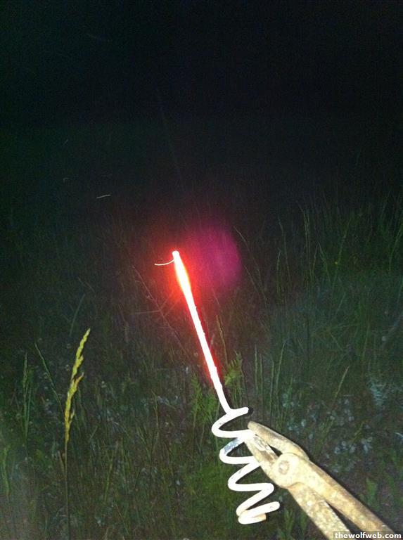

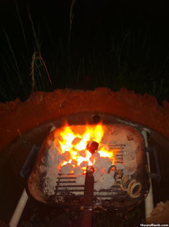

Finally got everything rounded up, taped down, hollowed out, poured and plugged in.
Very small setup. VERY. I used kingsford for my dry run and didn't bother crushing the briquettes. Hairdryer feeding into old vacuum hose reduced into a short piece of pipe i cut. Held together with aluminum tape but the heat stays well inside the barrel.

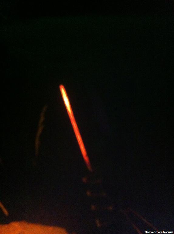

tossed an old spring from ...something in there just to see what color i could get into it anyway.
To me it looks OK considering no fine tuning and ect.
Still need to disable the heating element in the hair dryer so i can get some nice dense air running through there and also to keep from melting my pipe and running the power bill up.
Any thoughts?
5/11/2014 10:46:45 PM
41048 Posts
Yeah open up the hair dryer and cut the wires. I don't know if the pre heat would really hurt anything in this application other then the power bill.

thanks. I was actually unsure how cutting the wires might affect the fan.
5/12/2014 9:16:59 AM
Stryver
313 Posts
I've modified another hot-air blower (Popcorn popper) for a different purpose. It is possible the resistors (heating elements) are used as a voltage divider for the fan. If this is the case, it might not be advisable to cut them, and you might only be able to reduce the heat.
Find someone who has diagrammed your hair dryer and identified which parts are which or have a second one as backup and try experimenting.
