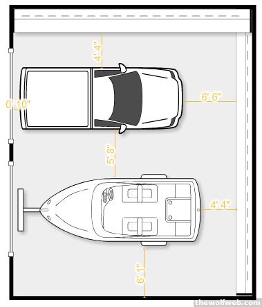

starting to get serious about building a detached garage and i'd like your opinions. i want to store my 17' center console and a full size truck and have room for a work bench and some working room all the way across the back wall. i would also like to have a few feet of storage space along each side wall.
i've got a friend who works at BDC so i'm looking at their packages. thinking in the neighborhood of 30'x32' or 30'x36' with a single 20' door on the front (gable end) and the service door on the side. 3 courses of block. i've found that a 20' door is preferable to two 10' doors, especially since the boat is very easy to manually roll around on concrete. door will need to be 9 or 10' tall to allow room for the center console (and possibly a higher center console if i ever get a slightly larger boat). house is cement fiber board and i'd love to match it, but there's already some vinyl in the neighborhood and it's very tempting to save the money and do vinyl.
does this sound reasonable/adequate? anyone venture to guess on a ballpark price? i'll do the permitting and such myself. got a good/cheap framing crew who did my mom's house who should be able to frame it up in a day. got a couple friends/coworkers who are licensed electricians who can wire it up at a good price. i'll insulate and sheath the inside myself. not sure where i'll go for concrete and masonry work. don't really want to try to do this myself like Jeepman and the other hardcore gayragers did in his garage build thread.

Nothing to add, but sounds like a solid plan.
I would, however, want to ensure that you have enough roll-up doors - unless it's more of a 'stash' garage and less of a workshop, if you feel me.

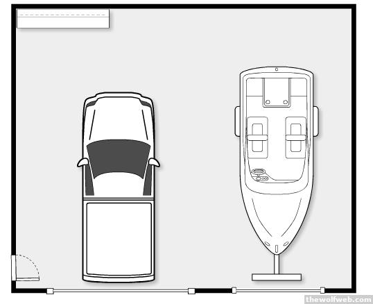

that's one of my concerns as well. i want to keep the cost reasonable, but i also want to make sure i build enough that i won't outgrow.
the idea is half "stash" space for the boat and half workshop, but i'll park my truck there when i don't have a project in the way. i don't mind parking my truck outside. i have a "2 car" garage attached to the house, but it's really more of a "wife's car and a lawnmower" garage.
but back to the roll up doors. i guess another option would be to put the doors on the long side of a 30x36 and have a 10' door for the boat and a 16' door for the project/truck parking space. that substantially increases my concrete cost (i've gotta add to the driveway and widen that end of it) and my roll up door costs.

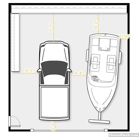

here's a 30x32 with a single 20' door. the cabinet/bench along the back wall is 2' deep. i wouldn't actually have a 30' long bench, but i put it there to simulate storing crap along that wall. i think this would work.

looks good, but tight. I'd say make it about 5-8ft wider if possible.

^^but keep the single 20' door or go to two roll-up doors? this is a 30x36 with a 16' door on the left and a 10' door on the right. this would probably be my ideal setup. it's gonna cost more for that additional 6' of door.

^I would do that dimension, but that 10' door doesn't do it for me with the boat.
what about 2 12' doors?

I have 12' doors on my shop and putting the car trailer is not to bad. I wouldn't want to go any smaller though. Unless you have a need for a 16' door, I would think 2 12' doors would work better for you.

I would think that a 30x36 with a single 20' door would also work. Offset, not centered.

I'd do two ten foot doors personally if you don't want to go with a 10 and a 12. So long as the entrance into the side you put the boat on is straight at least.

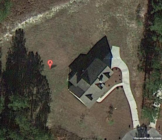

this brings up something else i'm struggling with. the dumbass way my driveway was installed.
i don't know why they felt a need to make it so crooked and curvy. anyway, i think the best layout would be having the garage parallel with the straight end of the concrete (not squared up with the house).

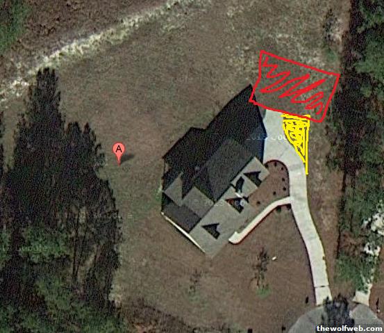

why not have it and the end of that pad, so kinda 45 degrees to the house

yeah, that's what i've been leaning towards

like this:
parking the boat on the right should be ok.

That's the way I would do it. And i'll throw in another vote for 2 12 ft doors also.

^^That's what I'd do. Get more concrete poured so the entrance straightens out some. Not a big concern with a 17' boat, but I know damn sure my 19.5' is a basically impossible to move once it's off the truck.
