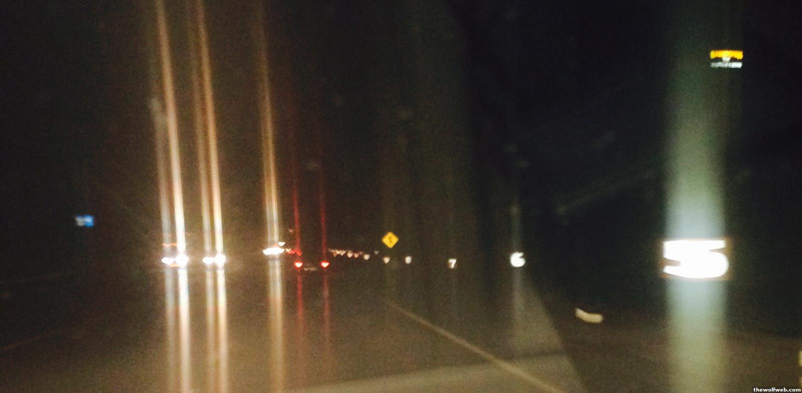

What are the small brown numbers signs on the side of 40 west, west of asheville
4/3/2014 10:21:39 PM
puck_it
15446 Posts
Looks like 5, 6, 7, 8, and possibly 9
4/3/2014 10:31:32 PM
