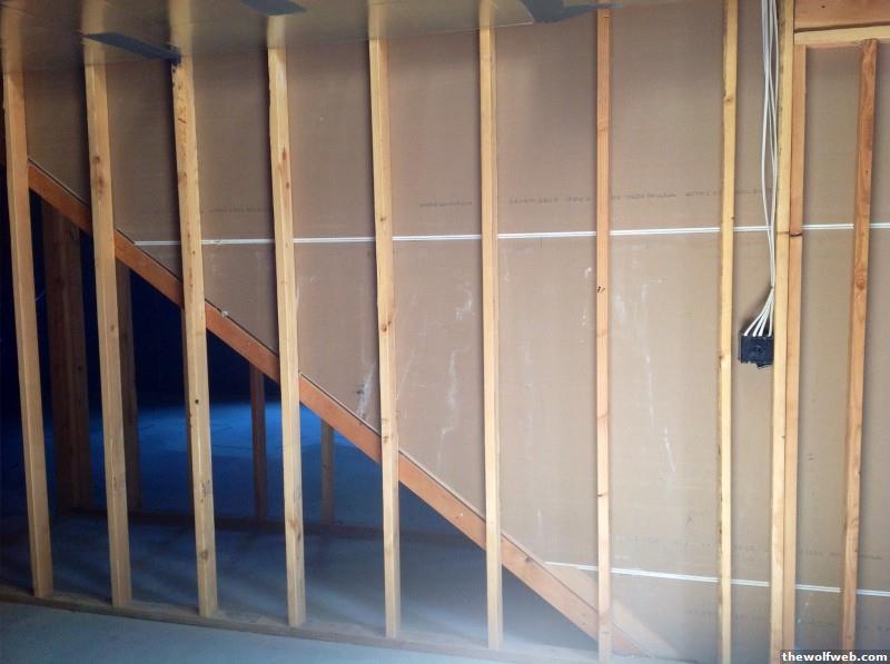

figured this would be a good thread to ask:
has anyone finished an unfinished basement lately? the house I'm looking at has a 1,300 sq ft basement, already framed for a bedroom, bathroom, and family room. Already wired and plumbed. Egress windows are in.
How much would you advise for insulation, drywall, drop ceiling, decent bathroom, decent bedroom, and basic family room (I can upgrade each of those in the next few years if I want).

ctnz71
7207 Posts
how much can you do yourself? i finished at $87/ft. $100/ft is what i figure when building a new house (without a fee)
3/22/2014 9:28:16 PM
ncstatetke
41128 Posts
I'll be able to do very little myself, aside from painting, bathroom fixtures, ceiling fan, trim work
^ so I should budget $130,000 for insulation, some drywall, a ceiling, a tub/shower/vanity. That seems high, but then again I have no idea

wolfpack0122
3129 Posts
I would think you should be able to get it done for $25K-$30K. Obviously it depends on the type and quality of flooring, fixtures, etc. I assumed basic carpet throughout with vinyl floor in the bathroom.
Framing for dropped ceiling $2,000
Insulation $1,000
Drywall $4500-$5K
Trim $4K-$5K
Paint $4K-$5K
Carpet $5K-6K
Vinyl $500-$1,000
Electrical $2500-$3,000
Plumbing $2,000 - $3,000
Random shelving/vanities, etc. $2,000
Obviously this is without seeing anything and just a general guide and I might be missing a few items, but you get the idea.

ncstatetke
41128 Posts
wish I had more pics. I'll try to go back this week and get some more.
to the right of the water heater room would be where the bathroom would go. to the back of the water heater room will be bedroom/office. through the door to the far right is the long, bowling alley size home theater. the room I'm standing in here would be the family room. doorway on the far left leads to the cold storage room
