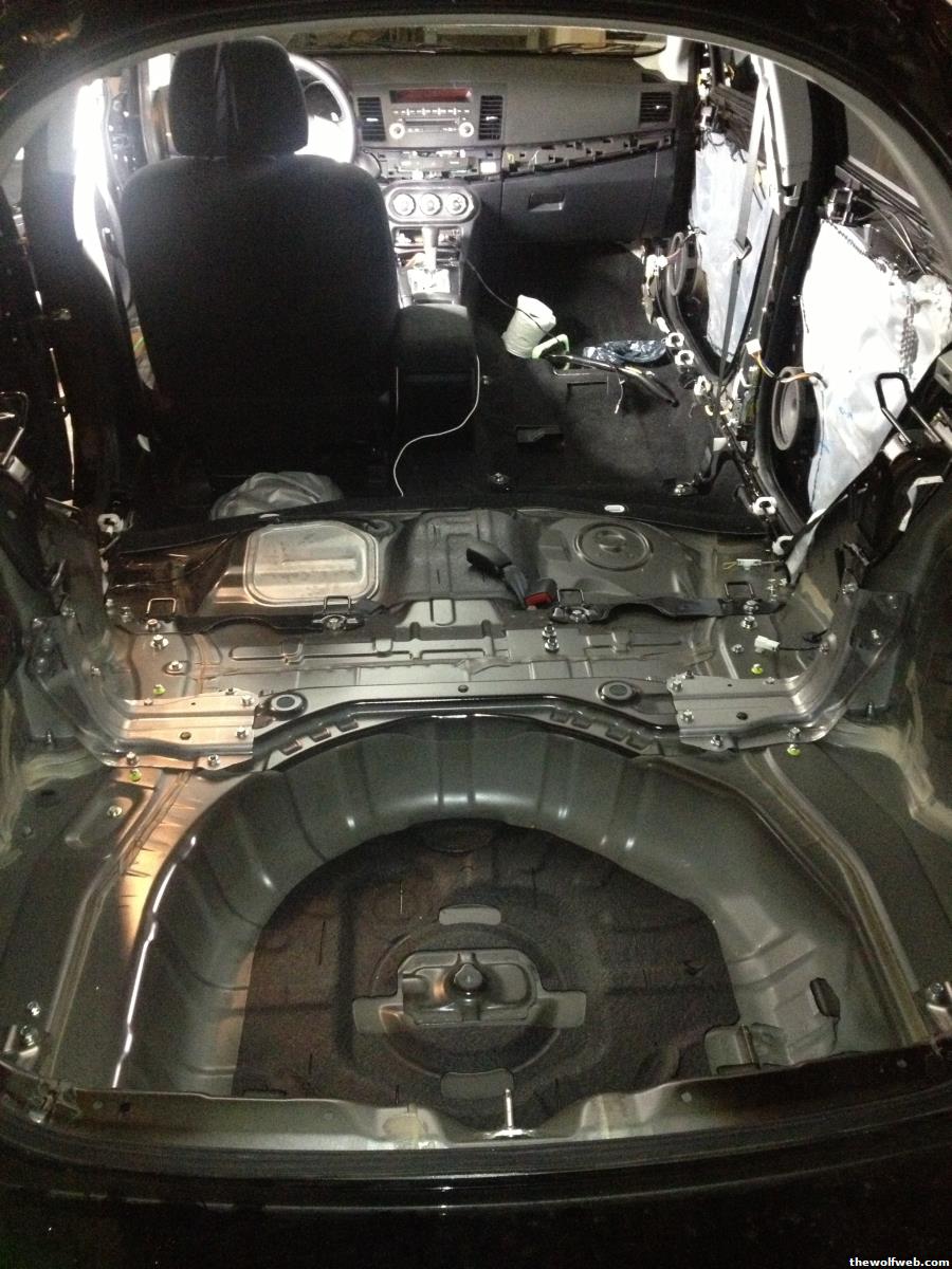

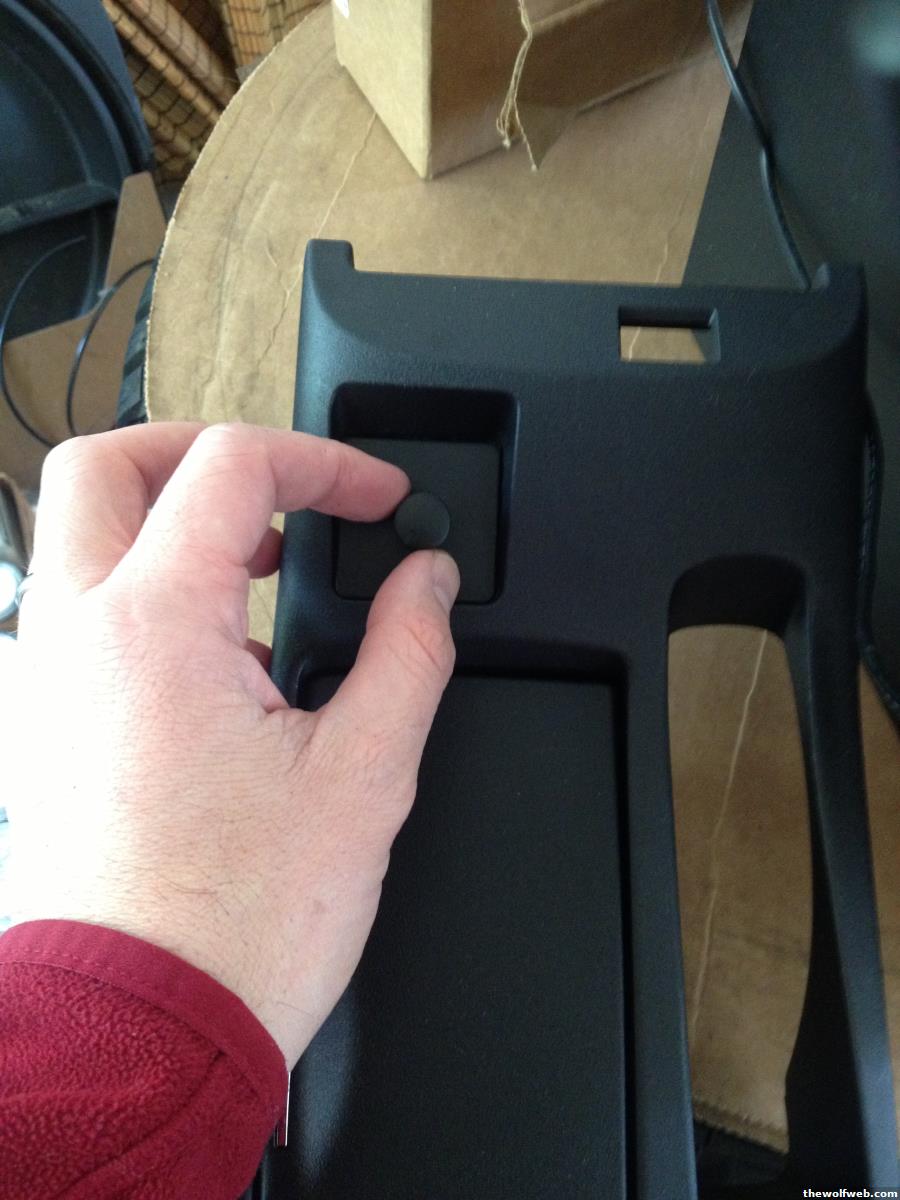

Picked up the ^^ powered sub above. Then bought the grill and the remote for it (RBC-1).
Just paid the Don from SDSD $1000 to send me the stuff I will need to sound deaden the car.
Hopefully this will all come in in the next few weeks, and hopefully I will have time to install it.

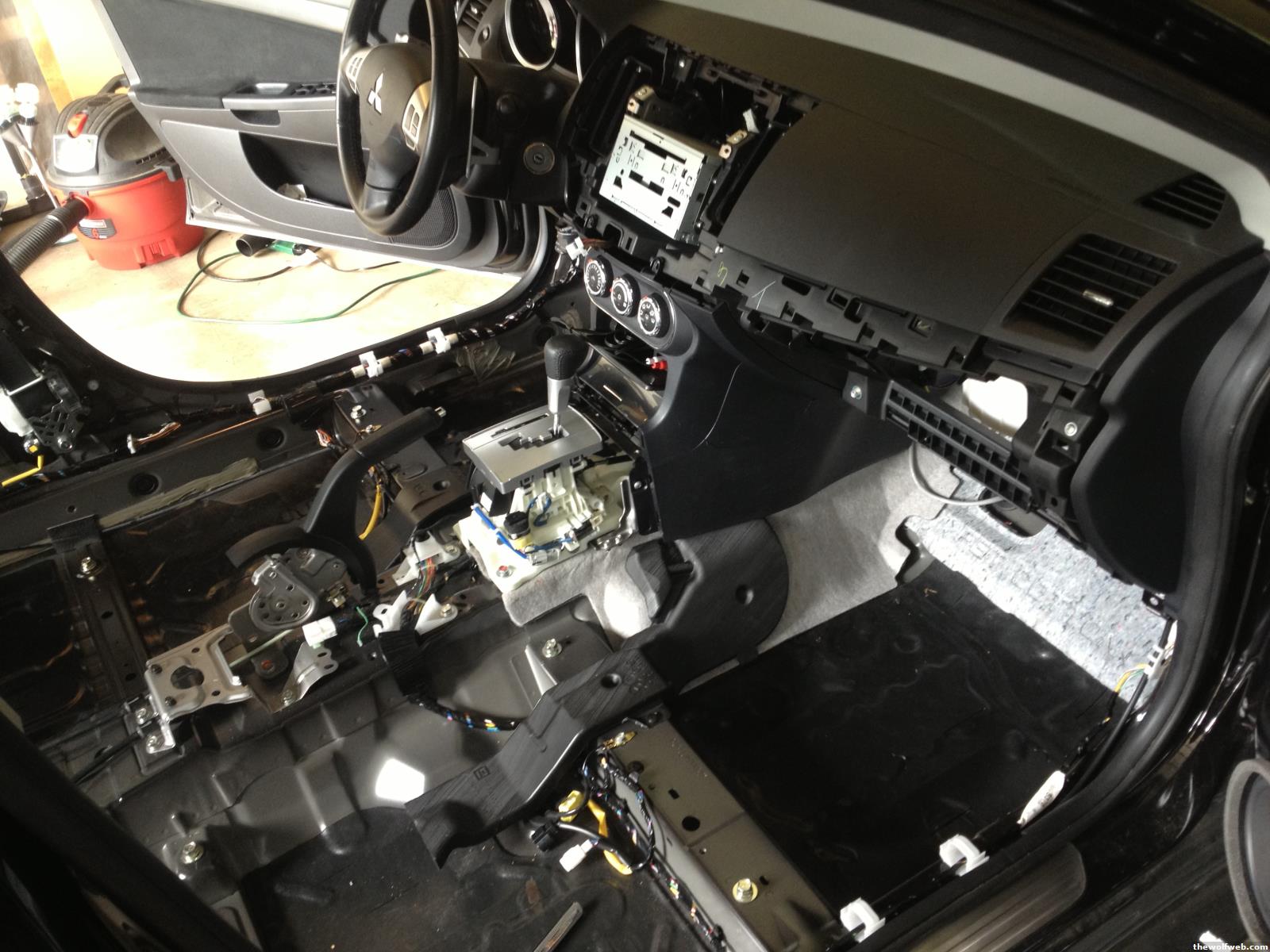

"Front Doors (each):
5 CLD Tiles, outer skin
1 CLD Tile, cut into smaller pieces, inner skin
1 CLD Tile, cut into smaller pieces, trim panel
Extruded Butyl Rope
7 ft² MLV
10.5 ft² 1/8" CCF
7 ft² 3M Thinsulate Acoustic
2.5 Velcro Strips, adhesive 2 sides
Rear Doors (each):
4 CLD Tiles, outer skin
Extruded Butyl Rope
6.5 ft² MLV
9.6 ft² 1/8" CCF
6.5 ft² 3M Thinsulate Acoustic
Kick Panels (each):
.5 CLD Tiles
1.1 ft² MLV
1.1 ft² 1/8" CCF
1 Velcro Strips, adhesive 2 sides
Floor:
6 CLD Tiles *
30.2 ft² MLV
45 ft² 1/8" CCF **
* I've specified 1/3 as many CLD Tiles as the area would normally indicate. Most vehicles have some stock vibration damper on the floor. Assuming it is in good condition and you don't intend to pull it out, this should be enough to treat the bare metals areas. There's nothing to be gained from adding CLD Tiles on top of existing material.
** Extra is to double up in the bottoms of the foot wells.
Back Seat Platform / Riser:
5 CLD Tiles
8.1 ft² MLV
8.1 ft² 1/8" CCF
3 Velcro Strips, adhesive 2 sides
Roof:
12 CLD Tiles
20.3 ft² 3M Thinsulate Acoustic
Cargo Area Floor / Spare Tire Well:
8 CLD Tiles, horizontal surfaces (assumes minimal coverage from the factory)
2 CLD Tiles, sides of spare well (assumes minimal coverage from the factory)
17.6 ft² MLV
17.6 ft² 1/8" CCF
4 Velcro Strips, adhesive 2 sides
Quarter Panels (each):
4 CLD Tiles
6.2 ft² MLV
6.2 ft² 1/8" CCF
Hatch Door:
7.8 ft² MLV
7.8 ft² 1/8" CCF
7.8 ft² 3M Thinsulate Acoustic
3 Velcro Strips, adhesive 2 sides"
It isn't just throwing some Dynamat down and calling it good.
[Edited on May 21, 2013 at 1:14 AM. Reason : indeed]
