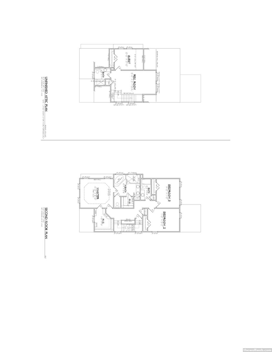

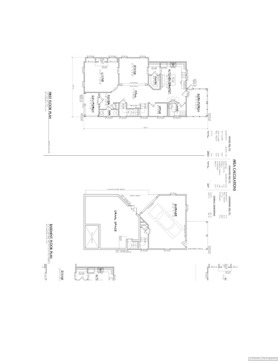

prelim drawings for you guys to tear apart. i know the porch will probably extend across the front

needs a room that takes up at least 2 floors
2/24/2013 6:12:21 PM
DROD900
24734 Posts
I really don't like that laundry location. I've never been a fan of having the laundry in the kitchen, and it's even worse that it's not on the same floor as the bedrooms
Who did your designs/engineering?
2/24/2013 6:20:46 PM

most moms (at least the ones we talk to) want the laundry on the same floor as the kitchen for babies/kids sleeping purposes
jeff spivey is designer. hasn't been to engineering yet.
lot is 58x135

Dang, narrow/deep lot. Seems like a good plan for the space. I'm also a fan of below-grade garages, as the garage door doesn't become part of the facade.
I had thought that area was mostly built out. Is this a teardown, or did they carve this off another larger lot?

Any thoughts on what you'd like differently about it?
How do you guys live on a day to day basis? Dining room and kitchen are setup with room to be more open, but this feels pretty formal. The lot you have, urban infill? If a muddy backyard is a regular thing, you have room to turn laundry to a combination mudroom and allow for a larger breakfast table in that nook.
2/24/2013 10:46:40 PM

^ I think we are pretty content with the design. As a builder, this probably won't be our forever home. Our first home we were surrounded by a lot of poverty... Now we are surrounded with the opposite. It should be an interesting change.

Overall good use of the lot size with your layout....only major dislike is the corner tub in the master bath (personal preference) . Are you doing 2x4 walls or 2x6 to exterior? What about sound insulation with the garage ceiling?

It will be a claw foot tub.
Garage ceiling will have to be insulated as it probably won't be heated/cooled. May drop a supply in there

The only thing I don't really like is the closed in family room.. I'd probably tear leave it open at the left foyer wall to the dining room wall, maybe even drop it down 8 inches (I have a new fascination with dropped living rooms)

Yeah, not a fan of the separated dining/living/kitchen.
If it was my home, I would have that kitchen flipped a bit so that you had island/bar space overlooking the "dining" area, which would be a large distressed wood DR table for daily use ... which opened up to the living area somehow as well. Sorta our dream layout ... with no functional "breakfast" area ... just a single flow kitchen, dining, living ...

I'm attaching a farm table to the island for daily eating. We think a formal dining room should be totally separate. Our first home had the living and kitchen connected and we hated it.

^^Just depends on personal tastes. I wish we didn't have a formal dining room and I agree that I also wouldn't put one in a place I was building but there are obviously plenty of people who still like that setup and I don't see it ever really going away anytime soon because it is a pretty traditional house setup.
I do agree for myself in the future, whenever we buy/build something new years from now we will probably just have a well laid out, open kitchen, dining, and living. We had to compromise on this house based on the area and not wanting to build new so we got a formal living room and formal dining room, and I really hate having that square footage in those rooms vs a more open layout with those 2 rooms removed.

"most moms (at least the ones we talk to) want the laundry on the same floor as the kitchen for babies/kids sleeping purposes
why, for the noise? I know a few moms like that, where there must be absolute quiet anytime the baby is asleep. those moms are stupid. If you go about your life normally, they get used to the noise and sleep right through it.
otherwise, laundry is always better on the same level as the bedrooms.
but, to each his... or her own.
2/25/2013 10:02:57 AM

^^ while I agree that a formal dining room is not always necessary... It is necessary in this neighborhood due to potential buyers and price point.
^ my kid spent the first year of his life in a noisey downtown. He sleeps well with consistent noises. Things like doors opening and closing and doing laundry right outside his room would wake him up or keep him from falling asleep. Again, a laundry room would not be a deal breaker to someone that would want to be in this area.
So my "stupid wife" is going to get the laundry room where she wants it.

I think the laundry room location is fine/normal. there isn't a better place for it.
anyone thinking that it should be on the second level is wrong. W/D's should not be on upper levels.

Our master and 2 other bedrooms are on the 2nd so our W/D are up there and I much prefer that to having it downstairs since our bedroom is upstairs. That's just us though. I'm sure other people have reasons they like them on the 1st.

large wobbling, loud machines with either large amounts of water or high heat on the 2nd floor is just a bad idea; especially when located near bedrooms.

It's not really that big of an issue. Our machines are not very loud, especially when the door is closed to the laundry room. In fact, the biggest issue we have is that we are watching, TV, reading, or doing something else around the house and we forget to check if the washer has spun out The heat is really a non-issue and I'm not really sure what the issue is with the bedrooms. We aren't doing the laundry while anyone is sleeping.
The only issue I really ever see and agree with is that a W & D on the 2nd floor has the chance of a leak from to the washer. We obviously have ours in a pan with a drain, but who knows how well it would actually work. But, it's not as bad as a water heater in the attic since it isn't just sitting around full of water all the time waiting to rust out. It would have to be a failure at the water connection or within the unit. I've never had a washer leak on my parents growing up or me. I guess the chance is there, but hopefully the catch-basin and dedicated drain would prevent any major damage.

Count me in as a fan of not having the W/D on the second floor and/or near the bedrooms. I like it near/beside the kitchen...preferably near a "mudroom" if you have one. I like this for several reasons:
I think it should be near front door/back door/some sort of ground entrance. As a kid, I was always coming into the house dirty as shit. I would take off my nasty ass clothes, step in the house, and toss them on top of the washing machine. Even now, when coming in from a long run/workout/dog walk...I can step in the house, immediately undress, and throw my clothes in the washing machine. Don't want to track that mess through the house.
No risk of noise near the bedrooms and/or leaks damage going through a floor.
Also in relation to the floor plans posted....I like a more open concept. You could have still had a formal dining room and had a more open concept with a kitchen being open to the living room/den (obviously you would have had to switch that plan around somewhat). I guess as long as your design allows future owners to be able to "knock out walls"...I just think it's something that everyone is gradually moving towards.

^yep. flooding is one issue (that pan won't do much unless you catch it early). fire from the dryer is another. I'd rather a fire start away from bedrooms and not on the 2nd floor (especially with 2nd floor bedrooms). For older homes (and poorly constructed newer homes), noise and/or vibrations can be quite the annoyance from 2nd floor W/Ds.
and as jbrick mentioned, having a true mud room/laundry room is great for coming in dirty and dropping nasty clothes right in the wash. These rooms also can make great "utility" rooms for convienent storage.

What are you doing with the crawlspace? Did you consider getting it truly sealed and semi-conditioned?

I thought about it. I need to look and see how the budget is going to end up

Seems like everybody these days are pushing for the open concept. So, why are dining/living closed off?
BTW I like the master bath design for the fact that you separate the nice tub from the toilet. I always when I see people put a commode right next to a luxurious tub.

Your 'living spaces' on the main floor are on opposite ends of the house. Was that the intended thought or? That order of living room-dining room-kitchen is a older format where the living room doubled as a sitting room/parlor. If you pocket door (large double) the connections between Dining-hall-living rooms it could still be a useful space. If you're spending most of your time in the back of the house having a good line of sight/sound to the front may be useful. Consider a shared access bathroom between the two bedrooms on the second floor. Laundry chute, consider it. Heck even a dumbwaiter lift from the garage up to the first level may be a good idea.
Odd that a traditional house in a traditional neighborhood wouldn't have a front parking pad at least, and would have to resort to street parking.
Back deck may want a staircase down to the backyard.

^^ the lot is 58x135 so space is limited. Street is not busy.

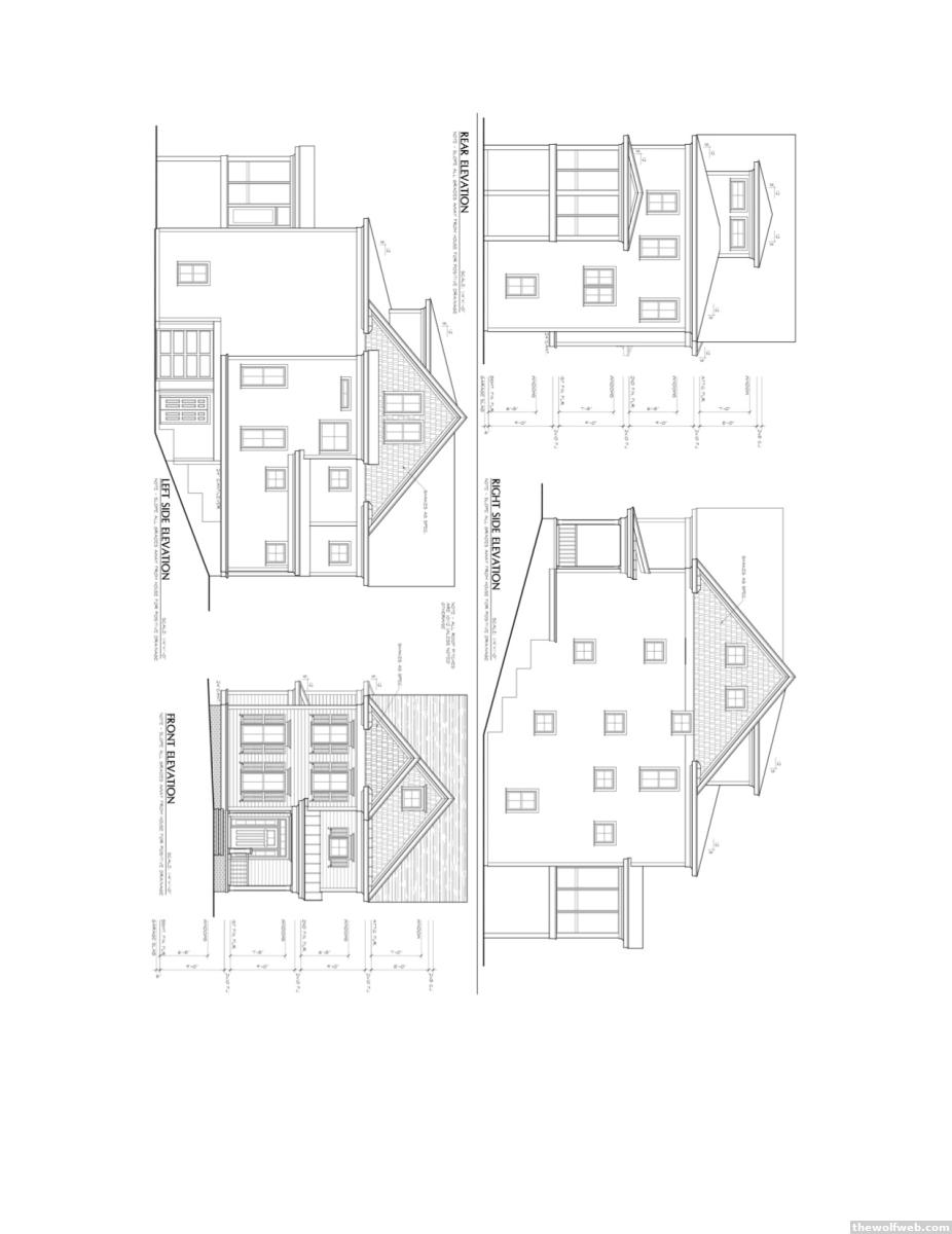

Looks like a mcmansion. Right side elevation is hideous

No one is going to see it. Not too concerned. It's 10' to the property line and theirs is 10 feet as well.

2530/3100 sq. ft. isn't really a McMansion. Also, seeing as how this house is being built not as a "lifetime home" but with the intention to move on 5-10 years down the road, you have to consider what your buyer will want. It's not super distinctive but it's not unattractive.
Another of your typical McMansion issues is building a home too big for the size of the lot. You can only do so much with a 58' wide lot, but assuming it doesn't tower over the neighboring residences and that it follows the established setbacks from the street, shouldn't have those issues.
