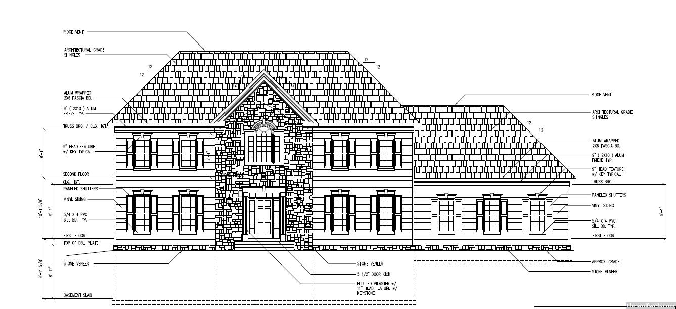

Front Elevation:

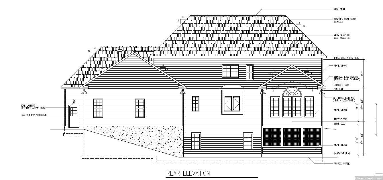

Rear Elevation:

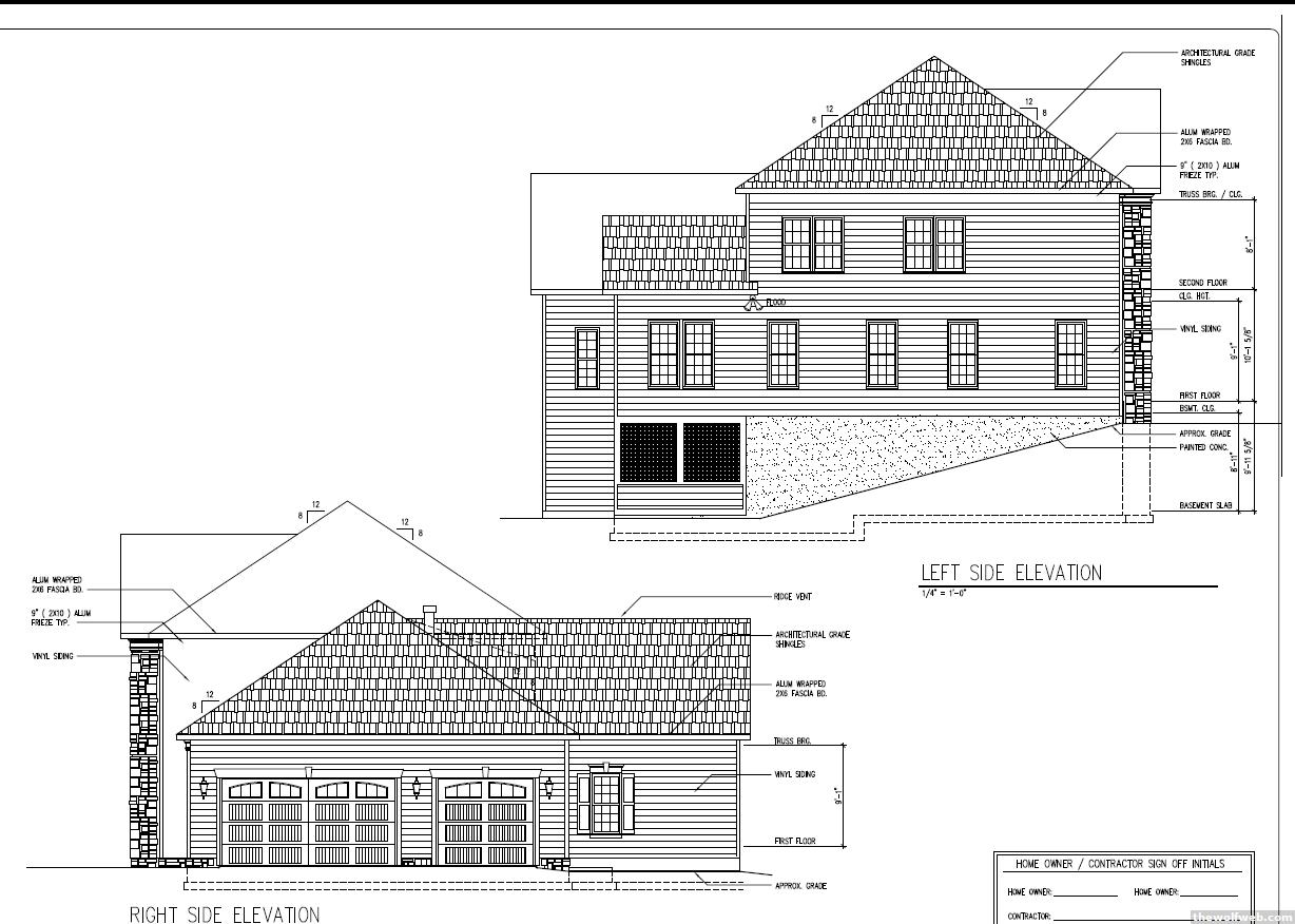

Side Elevations:

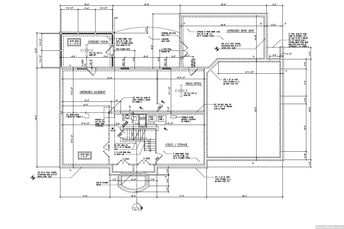

Basement:
Note the 15 x 28 workshop!!! WIN!

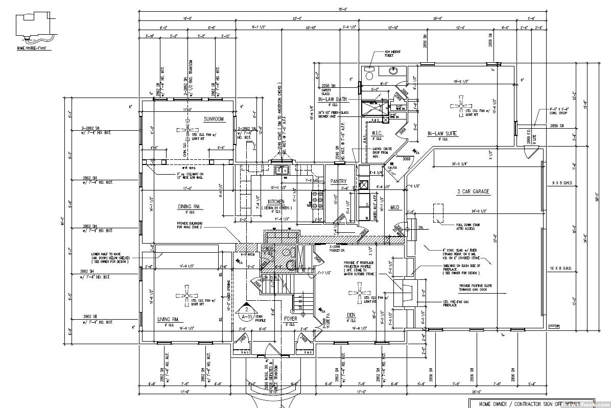

First Floor:

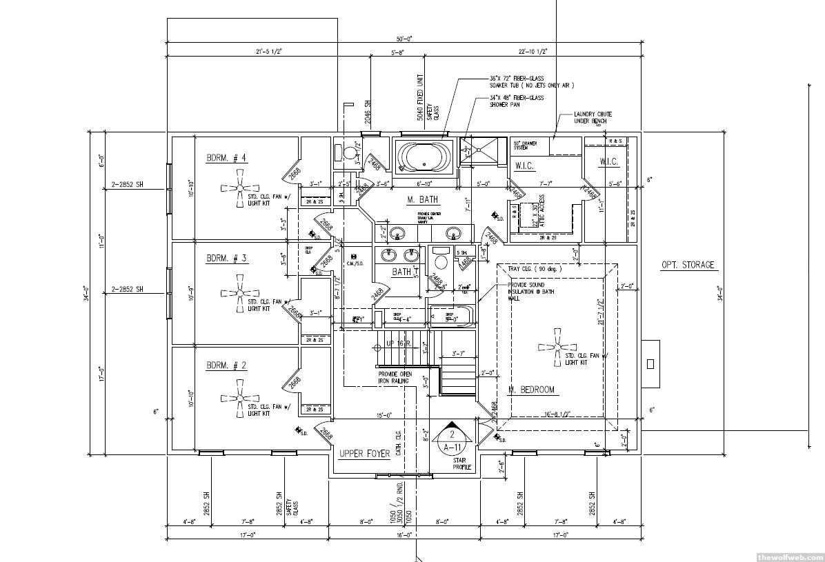

Second Floor:

Looks Ballerific, good luck!

laundry chute into the in-law suite?
2/18/2013 6:28:28 PM
panthersny
9550 Posts
Laundry shoot goes into the Mudroom (right next to the washer)

ncsustash
3421 Posts
Nice house....love the work spaces.
I don't understand why there is a walk in closet in a walk in closet.
2/21/2013 10:13:47 AM
panthersny
9550 Posts
^that is the his/hers WIC Closets. Originally one had a door into the bedroom but that made no sense since we lose wall space for a piece of furniture we wanted there...so we did it where its a closet in a closet, and mine obviouslly is the smaller one and my wife never has to go into it to see my mess!
win win for both of us.

Is there a reason why there aren't a lot of windows on the back of the house?
I've noticed most homes are like that.
I love the garages!
2/23/2013 10:50:06 PM
panthersny
9550 Posts
The rear of the home will have the southern exposure, so we don't need as many and the sunroom will let in tons of light.
The front being a northern exposure requires more windows to allow similar amount of natural light.....its the little things!
