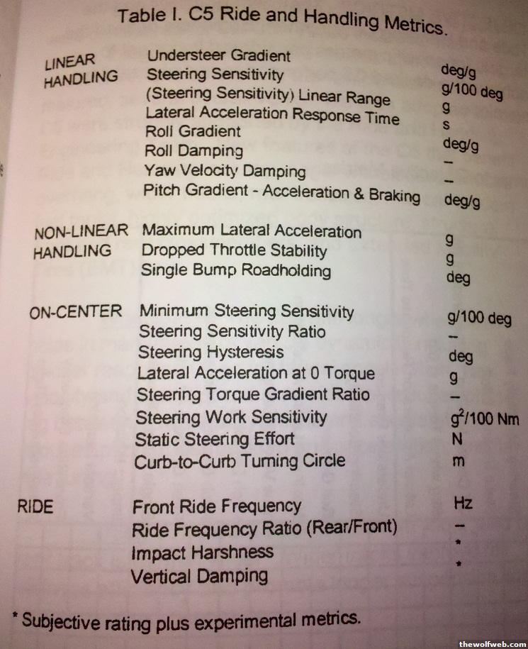

as far as the "Phd level" of discussion, you can map feelings of handling to actual quantifiable metrics.

Oh yes, the "feel" can be quantified to an extent. A few magazines have actually tried to do some shootouts with instrumented tests towards this end.
Where it really gets Ph.D. level is where you try to figure out where to alter all those myriad factors to achieve those quantifiable responses.
