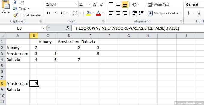

I know there has to be a very easy way to do this, but I can't figure it out. I want to have Excel search for a horizontal value, then a vertical value, then return the number that corresponds to their point of intersection. So in the picture below, if I wanted to find the distance between Albany and Catskill, the equation should return 34. Thank you very much for any help.

i've got an example setup, pm me your email address
the gist of my answer is:
insert a new column to the left of column B, in this new column type in the row number (so B2 = 2, B3 = 3, B4=4, etc...)
then you can use a combination of hlookup and vlookup like below:
=HLOOKUP(<cell containing row 1 value to lookup>,A1:E5,VLOOKUP(<cell containing column a value to lookup>,A2:B5,2,FALSE),FALSE)
[Edited on September 20, 2011 at 11:05 PM. Reason : add image for all]

OK, HaLo definitely wins this. I appreciate the participation/links but the actual formula was nothing like what I was doing with the Index function. Perhaps the Index function could be used, but I was unable to figure it out (I had been trying it for a good 30 minutes before I made this thread)

Yes you could use A combination of the index function with the match function as well. Slightly more "elegant" doesn't require inserting the column with row numbers.
