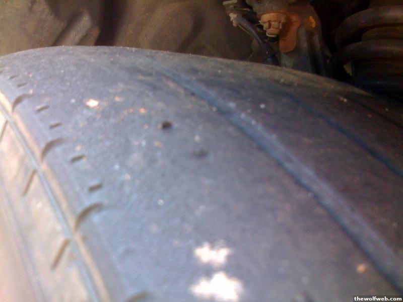

I've got a 07 Accord EX-L that I've had a for a little over a year. In that time, the front right tire has worn itself bald, while the other three look as good as the day I bought the car (they were new). The wear is even across the tire, it's not concentrated on the inside or outside. I've checked the pressure every month, and it's always been where it's supposed to be.
WTF? Any ideas on what's causing this and how do I fix it?

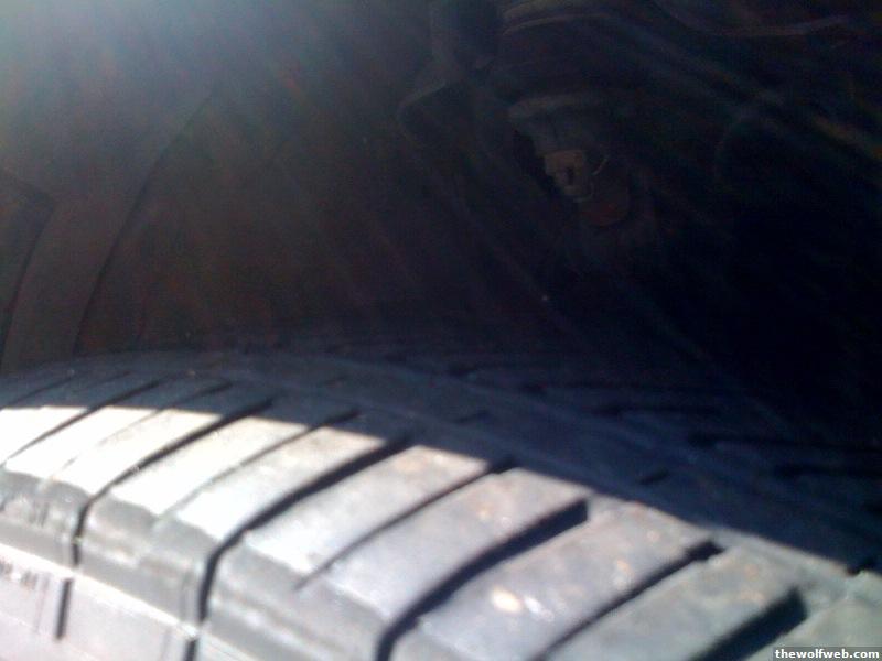

The tires are Michelin HX MXM4's, all of them.
Front Left:
Front Right:
Sorry for the shitty photos. The wear on each tire is even. Both look like the photos all the way across.

Rotate your tires and then check wear pattern again. This will point to a bad tire, or a bad suspension or alignment. An alignment is only 50 bucks, cheaper than having to keep replacing tires. Go to gowlers, last time i went they visually checked my suspension parts for free, told me what i needed to change, i went and did the work myself and came back and got an alignment for 50 bucks. Nice honest people.

If you've driven 10,000 miles than you should have rotated your tires twice by now (every 5,000). The wear is odd and I'm not sure of the cause but rotating the tires would have spread the wear out more evenly across more than one tire.

i can't take cred its zx's idea but i agree... especially now that you posted a picture i'm pretty sure you're doing burnouts on your right hand turns from a stop.
