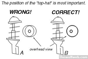

I would double check your top hats and make sure they are lined up with the strut perch. The shock rod isn't centered on struts and you can install the top hats turned a 1/4 or even half way in the other direction and it'll still go together fine. But it will rub on low speed turns and little humps.
Your springs are probably coming in contact with a little stud (from a bolt on the shock tower). When the shock compresses the spring may be hitting it.

a pic of what im talking about
