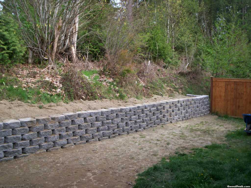

I built retaining walls this past week and need to break some of the bricks in half....my original plan of using a hammer and chisel is proving to be rather difficult and time consuming. Any one have any better suggestions? The bricks are 12inx8inx4in Castlewall from Lowes.

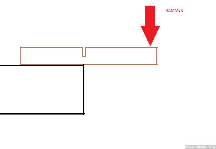

I see most masons do any one of these:
1) Use a masonry saw to cut the block all the way through
2) Use a masonry saw to cut the block partially through. Position the saw cut over an edge and hit the free end with a hammer to break it the rest of the way. (see pic)
3) Position the block over an edge and hit the free end with the hammer to break it. (see pic, imagine no saw cut)
