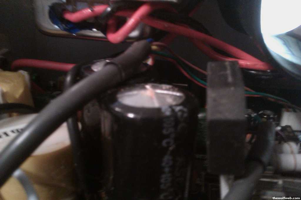

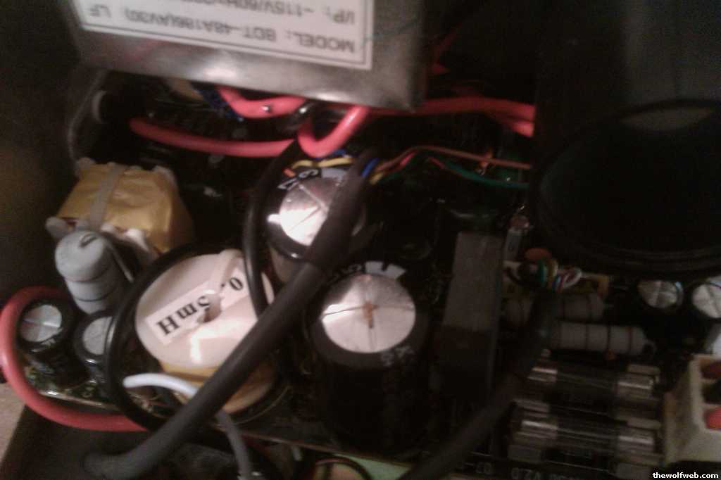

so I fear that I might be the victim of the capacitor plague
I've got two bulging capacitors with a little bit of electrolyte on top

64489 Posts
some pics of the capacitors

I need two 4700 uF capacitors (electrolytic)
the power source outputs 14V (x2) @ 8A
found 'em on DigiKey
they come in a 16V and 35V version
suggestions as to which I should go with?

Potty Mouth
571 Posts
The 35v. But, you should be able to see on the caps on the board what they are rated for.

is there a reason the 35V is preferred?
there are two capacitors
is it safe to assume that the power source puts out two 14V rails running independently to the caps?
I took the speakers apart further and confirmed that the caps are 35V

Potty Mouth
571 Posts
2v really isn't enough margin of safety. On power up I wouldn't be surprised if those rails rise above 14v for a brief period of time.
Be absolutely certain you get the polarity right when you replace them. On the positive rail you'll have the ground terminal of the cap to ground, on the negative rail you'll have the positive terminal to ground.

fregac
4731 Posts
With filtering caps you always want them to be rated well above the voltage you will be dealing with. 10v or more above, usually. Most caps for a 12v rail will be rated for 25 or 35v.
Also, you'll need proper Low ESR caps. Something from Radio Shack won't cut it, they'll just die again.

Snewf
64489 Posts
I replaced the capacitors and the speakers are working!
