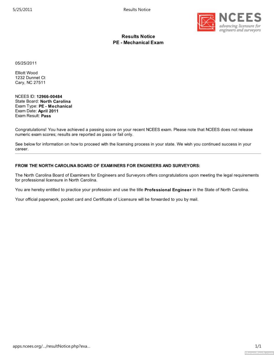

Elwood
4400 Posts
oh yeah i passed!
5/25/2011 5:38:49 PM
UberCool
3457 Posts
way to go, dude!
(me too )
5/25/2011 6:41:45 PM
