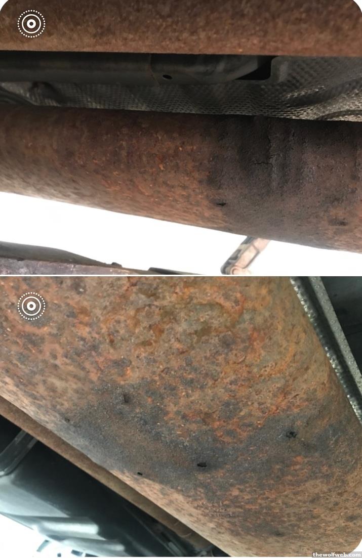

Anyways, I don't know much about this shit so needed to make sure I'm not getting ripped off. Brought my 08 Rav4 in to a mechanic for some check engine light stuff (rodent at some wires apparently), and mechanic also says I need a new muffler. Gave an estimate of around $750.
Being that this car just passed inspection a few months ago and they had no problem with the muffler (I assume they check that), does it make sense that I would have a problem now? And does that price make sense. When I google "Rav4 muffler replacement" I see a bunch of stuff for like a hundred bucks, but if I Google, "how much to replace a Rav4 muffler" I get shit that says $500- $1200. Anyways, here's a picture the mechanic sent of the muffler

Seems a bit steep to me.
Here is a diagram of your exhaust
http://www.rockauto.com/en/moreinfo.php?pk=3483465&cc=1441511&jsn=9
Part 280-605 is $90 and can be bolted on pretty easily. It has a slip joint on the front (left side) to part 096-1673 which is apparently the Catalytic converter. That part is $165.
Prolly a good bet to get gaskets for both ends too, so throw on another $20 and you are at $280 in parts, and thats without any discounts or shopping around.
If the car isn't any louder than it normally is, I would keep on rockin and start stashing a bit of cash to fix it down the road.
If you don't particulary care 100% about keeping it stock or whatever, just take it to Henry's muffler or equivalent and get them to throw something on.

i'd run that piece of shit until i couldn't stand the sound or i couldn't find an inspection station to pass it. fuck it.

What about carbon monoxide leaking into the car if there are holes?
2/12/2018 8:45:49 PM
35583 Posts
not likely, but if you get a headache, crack a window
[Edited on February 12, 2018 at 9:09 PM. Reason : serious: you're traveling forward. there's wind and such. it's not gonna make it in the cabin.]
2/12/2018 9:08:46 PM
1. Unless you are stationary for long periods of time, CO will not be an issue
2. I wouldn't touch it unless you can't pass the state inspection.
3. The mechanic may be technically correct as yours is showing some signs of [likely] damage; but he's trying to sell you something, so there's that. He's not dishonest, but he isn't completely forthcoming; assuming there is nothing wrong beyond whats in your photos.
4. Bout tree fiddy to fi hunned, depending on the selected muffler and shop for replacement.
5. Nice thread.

Thanks for the input everyone. My concern on the CO is mostly for my 1 and 3 year old and a wife who worries about that kind of stuff.
I think at a minimum it's safe to say I should bring it somewhere else and get a second opinion, if not forget about it for now
2/13/2018 10:30:32 AM
35583 Posts
there are millions of folks driving around with exhaust leaks, many of them much worse than that. have you ever heard of anyone dying from CO in the cabin from such a leak?
