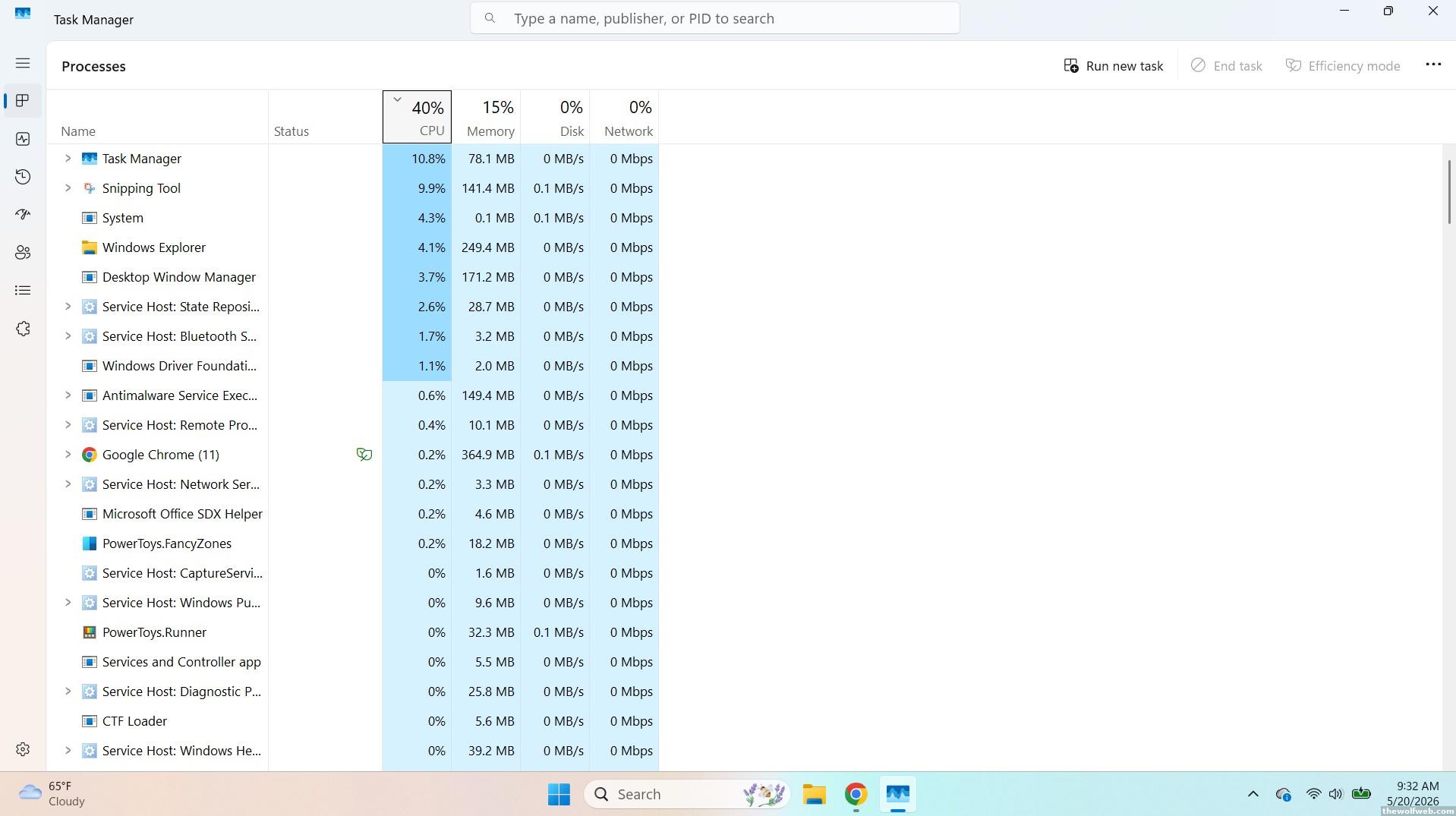

lately my computer seems slow, any tips to increase the speed? i upgraded ram to 64gb so i figured it would be snappier. I know its an i3 processor but figured 64gb of ram would be better
it seems laggy and all i had was one tab of google chrome open, and snippet tool and task manager. any tips?

CaelNCSU
8163 Posts
Install Linux. Or reinstall Windows from scratch.

18632 Posts
I mean there are 15 year old i3's and 1 year old i3's.. which is it

Titties!
16590 Posts
Gen 12. Like i3-1225 or something like that

tchenku
midshipman
18632 Posts
Shit's old but fine if you just want to browse and watch Youtube videos. If the hard drive is nearly full, clear some stuff out. Keep it at least 20% empty if you can. If you do that and it's still slow,
"reinstall Windows from scratch."
