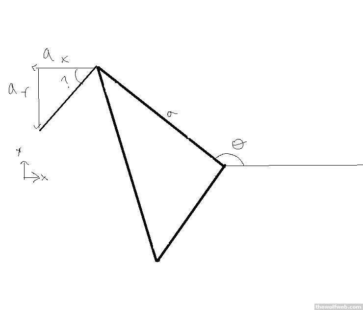

So I'm working on something and I've got myself stumped on part of it that I know is something easy. I know it is basically a really easy dynamics problem, but I keep confusing myself for some reason. I need to relate the lateral motion of the top top point to the downward motion of the bottom point.
can someone please give me some fresh eyes on this

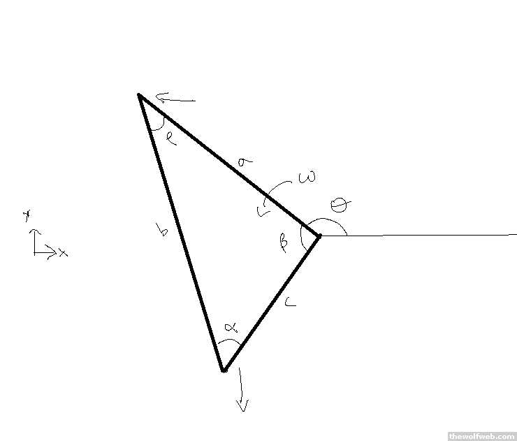

also, omega is roughly constant.
so the position of the top i guess is the vector a, and the bottom is the vector c.
i know its not hard, but the last time i did anything having to do with dynamics or vector analysis was 7 damn years ago

(a-c)(sin(t-B))=c(cos(t))
t=theta
based on the parametric equations for a circle: http://mathworld.wolfram.com/ParametricEquations.html
[Edited on February 27, 2010 at 10:09 PM. Reason : this is wrong actually...]

i mean i can relate any of the sides together with the law of sines or cosines, i even labeled the angles and sides according to the conventional definitions.

sarijoul

speed of each point is proportional to distance from the rotation point. then you just have to deal with the cos/sin to figure out what proportion of that motion is up/down and left/right

i get that v=omega*r how do i get x and y scalars?
2/27/2010 10:00:42 PM
sarijoul
14208 Posts
use trigonometry to figure out the angle from the horizontal for the two points.

well, you know that the velocity is perpendicular to the radius

eg at theta = 0 velocity of the top vertex is all vertical. at theta = 90 it's all to the left. the same sort of logic can be used for the other vertex with the angle theta + beta.

"eg at theta = 0 velocity of the top vertex is all vertical. at theta = 90 it's all to the left. the same sort of logic can be used for the other vertex with the angle theta + beta."
thats only true if beta = 90, beta does not necessarily equal 90
(in fact it almost certainly is greater than 90 in my case)

when theta=0 the bottom vertex will be moving down AND to the left
tangent to c
[Edited on February 27, 2010 at 10:19 PM. Reason : .]

that's why i said that you use theta + beta for the bottom vertex.
^and it would not necessarily be tangent to c
[Edited on February 27, 2010 at 10:20 PM. Reason : .]

forget entirely about the triangle. and treat is as two separate lines. each with an angle from the horizontal
for the top vertex, the angle is theta. for the bottom, let's called that angle lambda. if lambda is 90, the motion is all to the left. if lambda is 180, all down, etc.
now replace lambda with theta + beta.

figure out the horizontal and vertical components of those velocities using conversion from polar to cartesian. and you can relate that because they both use theta in their formulations.

14208 Posts
wait. all you need is the x component and y component, no?
Vx = -r*sin(theta)
Vy = r*cos(theta)

ax=a*cos(t) (lateral motion of top point)
cy=c*sin(t+b) (downward motion of bottom point)
or
in polar...
motion of a with respect to theta(t):
r(t)=a
motion of c:
r(t+b)=c
2/27/2010 10:41:25 PM

^that's not right. you need a derivative for velocity, Vx = -rsint, Vy = rcost

no. he wants vertical/horizontal component of velocity. which he said in the first post.
