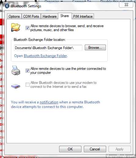

BigEgo
Not suspended
24374 Posts
not promising anything but if you try to create a bluetooth link between the two, enable ICS on one of the laptops and on the other try to see if it says anything about using it to connect to the internet. I've seen options like that for other devices on windows 7, but never tried it with another laptop.
fucking around with my bluetooth settings I found this:
so you can do it if your hardware can I guess
2/24/2010 2:44:08 AM
MaximaDrvr
10412 Posts
hmm, that would work.
Guess I would need a newer laptop, or be with people that have a bluetooth capable laptop. I have no way to test that theory myself.
