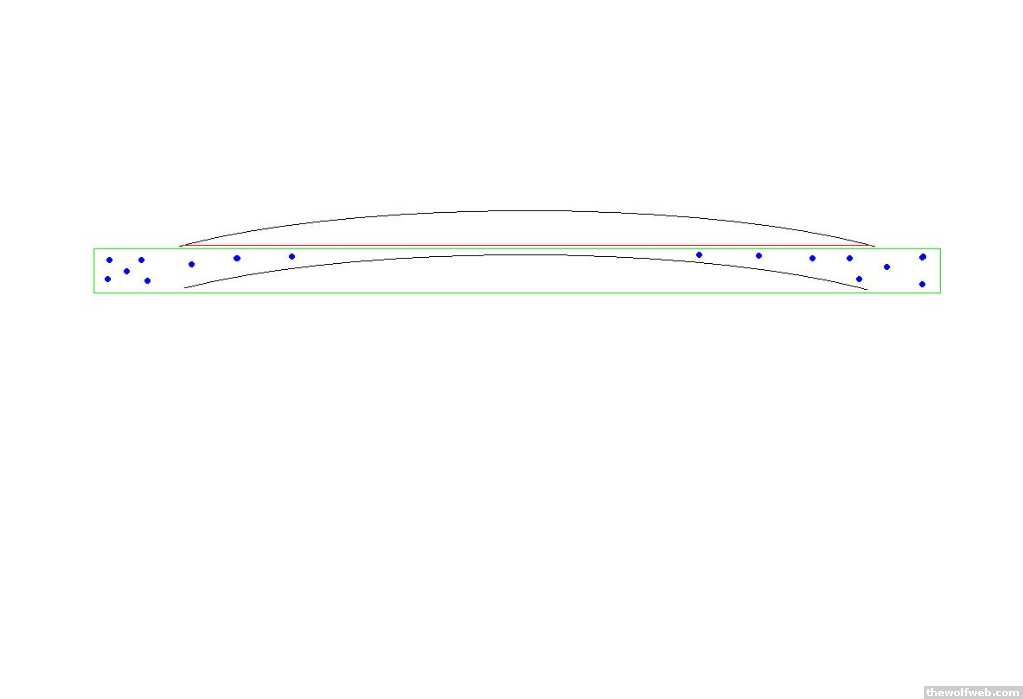

69
15861 Posts
its exagerated, but the black is your current floor joists from what i gather
after you take up the subfloor, you need to find the lowest point, then make a level line along all the joists from that
then cut along the red line like in the picture
add the green 2x6's level or slightly above your cut if it's kind a crooked with plenty of 3" screws (blue)
[Edited on November 24, 2009 at 8:34 PM. Reason : pic]

69
15861 Posts
it all depends, if it a a short section thats warped <8' and its only and 1 1/2" that needs to be cut off, and its a 2x8 or better yet 2x10 joist, then you don't really need to worry about bracing it after you trim it, but you do run the risk of the floor flexing and the tile or grout cracking
