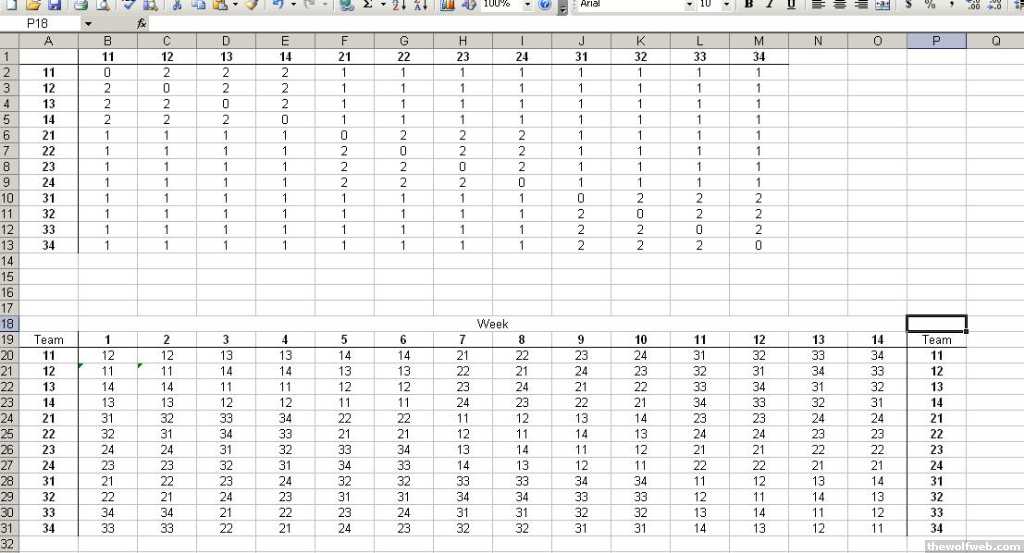

What I did (though not completely automated):
Created two tables:
I numbered the teams so that the first digit is division number (1-3) and the second digit is team number (1-4).
The top table counts how many times the teams play each other and uses the formula COUNTIF($B20:$O20,"="&B$1)
The lower table is the schedule. I filled in the top row manually and filled the remaining cells with VLOOKUP($A21,B$20:$P20,16-B$19,FALSE). When you enter one game (e.g. 11 vs. 12) the formula fills in the cell for the other team (12 vs. 11).
Fill in the games from the top down.
8/21/2009 12:49:08 PM

Thanks for this example, this could work out pretty well.
