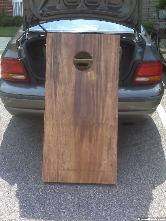

I bought a cornhole set that has two coats of lacquer already applied. I had planned to paint a Hurricanes symbol on each set but I am unsure how to go about doing this.
I live in an apartment complex so it makes it a little difficult to do the sanding and mineral spirits and etc without disturbing my neighbors as suggested here: http://www.democraticunderground.com/discuss/duboard.php?az=view_all&address=105x7593402
Any suggestions? Can you paint the symbols over lacquer with acrylic and then lacquer on top of that?

Here's the board:

So, back on topic...Can I spray paint over the lacquer with a spray paint for plastic or will I have to strip all the lacquer off?

EDIT: no spray paint, it might stay on for a while but it'd come off before too long. How you decide to go about prepping the board and painting it is dependent on what design you decide to go with.

I like the one black, one white with the hurricane and the flag. Will I have to strip all the lacquer off to paint them solid colors?

http://answers.yahoo.com/question/index?qid=20060919105424AAkh344
seems like using that killz stuff should do the trick.
7/8/2009 12:42:48 PM
dbmcknight
4052 Posts
i personally would sand it all off and paint it however i wanted to. dunno how much trouble that would be, as you said you lived in an apartment. you could do it in the parking lot, i suppose.
[Edited on July 8, 2009 at 12:49 PM. Reason : or rough sand, prime and paint, as was already suggested. that would probably do the trick.]
7/8/2009 12:48:39 PM
CleverFilth
845 Posts
sanding by hand would take some effort, and i'm not sure if the surface would look too great afterwards.
i would do a light sanding after using the killz product though. just don't rely solely on sanding.

Well, I bought the Killz Primer for indoor/outdoor for about $7 and I have primed both surfaces in the "yard" and I'm waiting for them to dry.
We were going to paint one white, one black but you cannot see the black at night so we have decided on one white, one red. Still not completely set on the design.

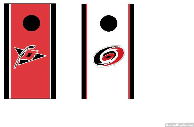

So here's the idea I am thinking of using. I did this in Paint so ignore the crappyness.
How can I make it better? I don't want to get TOO detailed but I feel like it's missing something.

how about some text. perhaps, "Canes!" or something

My script sucks.
I would find painting the name to be the most difficult part.
Worth a shot.

put lines on it like an ice rink

you can go to Wal-Mart or any arts and crafts store and get stencils of letters or stickers for mailboxes and whatnot that you can outline onto the board and color in.

"put lines on it like an ice rink"
See, we thought about this but I don't think it will work out of we put the logo on there.

i think it looks good the way it is

i agree, i think it's fine the way it is.
but if you must add something else, maybe a pic of the stanley cup and 2006 under it?

I really like those designs, especially the lines on the edges.

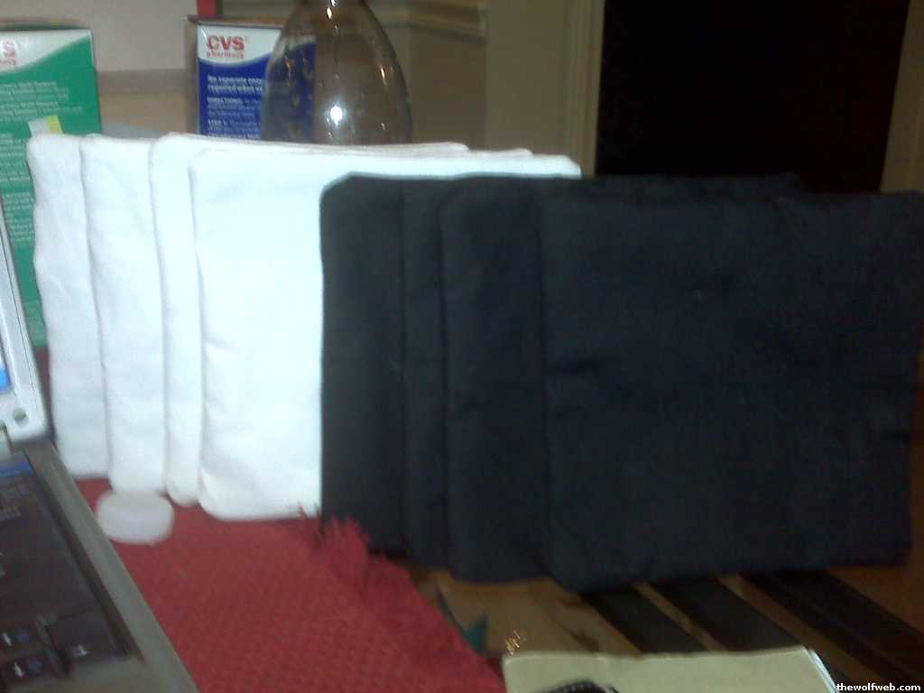

4 of the 8 bags are sewn. My sewing machine does double stitching so they should be pretty sturdy. Making them white and black since they didn't have red duck cloth. I might dye the white ones red so they don't show dirt as badly. I'll post a picture of them when they are finished.
If anyone wants me to make them some, make me an offer.

That paint is going to orange peel eventually.
The only paint you can put over laquer is more laquer or other oil based paint. Anything else is eventually going to react and fuck up. Laquer is a oil based paint with suspension chemicals. Unlike acrylics, it never "sets".
And stripping it is a serious, noxious mess. You would have been much better off buying the plywood boards raw, and then sealing them yourself. And the advice in that thread for sanding the laquer finish down is only going to delay the inevitable. You need to strip it off, and you should use a paint stripper to do it.
Killz will work great, as it's oil on oil. But if you spraypaint over that, or use acrylic over that, it's going to get fucccckkkeeed up and either orange peel or come off in sheets as the humidity gets to it. I'd continue with oil based paints for the colors, plop the sitckers on there, and then use another clear laquer over the top.

"Killz will work great, as it's oil on oil. But if you spraypaint over that, or use acrylic over that, it's going to get fucccckkkeeed up and either orange peel or come off in sheets as the humidity gets to it. I'd continue with oil based paints for the colors, plop the sitckers on there, and then use another clear laquer over the top."
Good thing I got all oil based paints to go over the Kilz.

Here's a picture taken with my phone of the empty bags. Gonna stuff them tomorrow. They haven't been pressed yet so ignore the wrinkles from turning them right side out!
