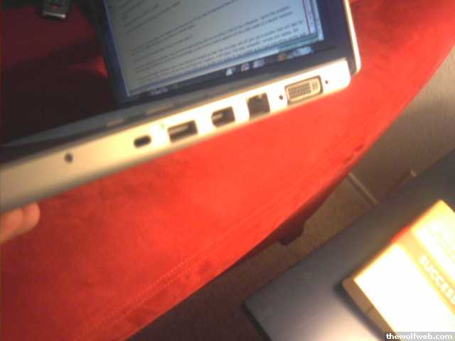

*edit-- the port doesnt literally look like l [ ] l thats just the icon near it. i cant describe how it looks besides a bunch of pins with a flat looking part

^she has an original Macbook Pro
You need a DVI->HMDI or a DVI->DVI cable. depends on what inputs your television has.
If you have a DisplayPort (which you shouldn't since this is an old laptop)
12 bucks.
Otherwise you need either this 8 bucks or 5 bucks
In either case you'll want to get an HDMI cable with the adapter, 5 dollars

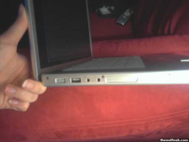

got pics of my laptop inputs

Do you have pictures of your inputs?

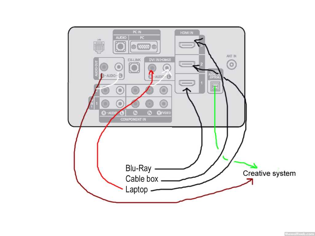

Even simpler than ^
*this is assuming your Creative sound system can take an optical (tos-link) input*
green: tos-link (6' for $2.14)
http://tinyurl.com/2cynkv
laptop dvi-to-hdmi cable (15' for $6.69)
http://tinyurl.com/2wnbvd
the "optical out" on the tv may not output the analog sound from your laptop cable, in which case you can keep the red/white cable connected straight to your Creative system.
For a more permanent solution, hook it up as shown in the drawing. You'll now need the burgundy wire (which will be the same type as the red/white adapter you already have):
stereo plug to RCA adapter wire (6' for $0.63)
http://tinyurl.com/2dxeqa
For some extra slack in the analog wires:
stereo plug extension wire (12' for $0.85)
http://tinyurl.com/b37276
If you can switch between digital and analog inputs on your Creative system, then you've got it made. If not, then you'll have to do the swapping bit, but at least you'll be messing with the sound system instead of being crammed behind the TV messing with wires.
Make sure you specify analog sound for your HDMI 2 connection.
[Edited on April 29, 2009 at 9:42 AM. Reason : ]
