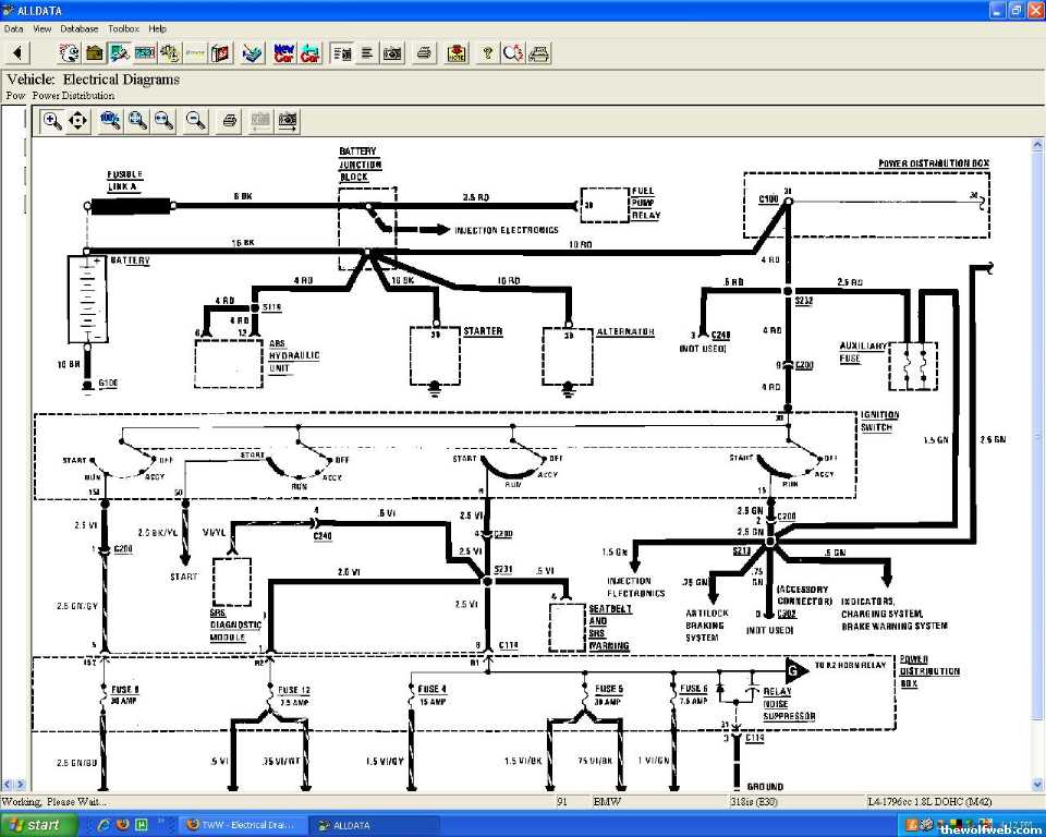

69
15861 Posts
dear lord baby jesus there is a lot of shit tied in everywhere
this is what you're workin with
I would disconnect the cable from the battery junction block to the power distribution block, let it sit, and report back.
If it doesn't die, that rules out your alternator, starter relay, abs unit, and fuel pump relay.
Then I would disconnect the wire coming off the main wire from the power distribution block, that leads to a whole lot of stuff that isn't fused in the block.
All this is assuming your amp and aftermarket stereo is unhooked and we are dealing with a vehicle wiring problem.
