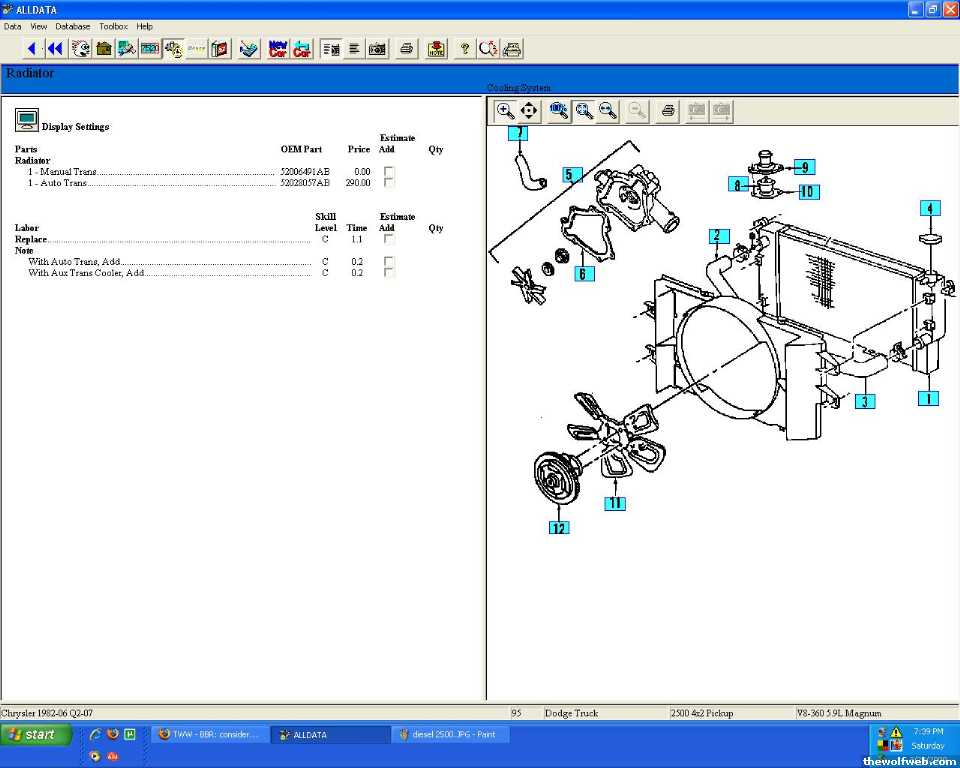

yo dude, could you get a couple pics of the radiator and upper mounts on Rufus (is that the name ?) I'm wondering and assuming that the gasser radiators in the 1500's are smaller than what I have, and that both mount sets are indeed present on that front end structure.
If that is true, I could swap to the smaller radiator, which would aid in shaving some weight and allow for some more advantageous intercooler configurations
note: i havent searched this, and 69 might can glean this from alldata. enjoy reading the thread, my raging gayers

"swap to the smaller radiator"
im no engineer but ive always bought bigger radiators. why would you want to put a smaller radiator on a 4k pound truck? is this a trucker special thing to do?

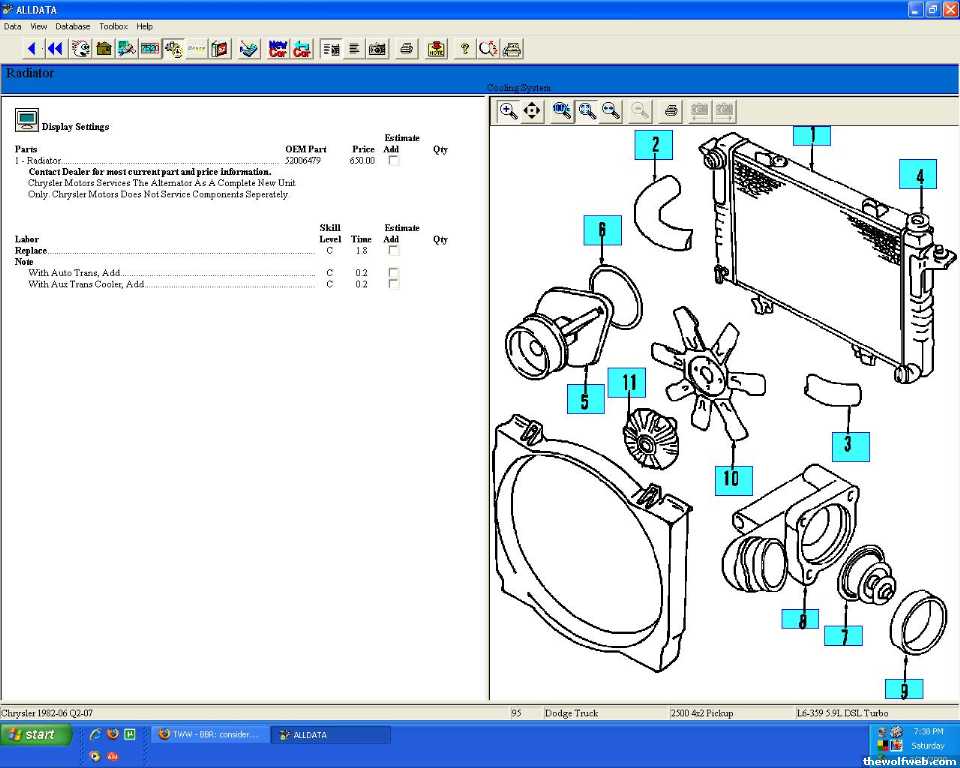

is the 1995 dodge ram 1500 radiator different from the 1995 ram 2500 cummins radiator?
if so, I assume it is smaller, which would benefit my application
well I am going to assume that the 1500 gasser radiator (if smaller) would still be adequate to cool my engine for the conditions that it normally operates under... i.e. minimal loading/street driving, etc.

judging from what looks to be an alternate radiator mounting boss, the assumed smaller radiator would be about 3-4" more narrow overall

69
15861 Posts
the gas 1500 and 2500, 5.2 and 5.9 radiators are all the same, just with or without a trans cooler for the auto
the diesel 2500 looks a lot different
gas
diesel

the thought of being able to run a better intercooler tank design excites me
jesus christ look at that price difference-
" i just dont see the use in a narrow radiator. i thought the bigger the fins the better"
think of it as having an excess of cooling capacity, and I could do with less, because I'm not pulling trailers or hauling shit or whatnot. the 94-02 cummins have a shitty intercooler inlet/outlet tube design that could be improved upon

it should fit if thats what you are asking, the 1500 and 2500 gas radiator part numbers are the same, and the 2500 diesel and gas bodys are the same, so yes it should fit, but you may need the little brackets for it

yeah, there's another set of threaded inserts where the upper bolts go (the basis for this conjecture of a thread)

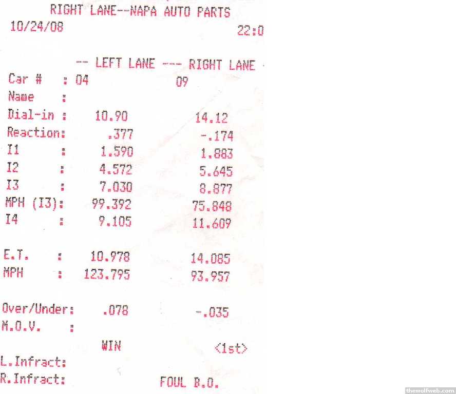

hell, mine runs a 8.79 @ 79mph stock in the 1/8th whenever i get the time and money for a modest setup, i should be making an additional 130hp and 210 ft/lbs at the rear wheels

"hell, mine runs a 8.79 @ 79mph stock in the 1/8th whenever i get the time and money for a modest setup, i should be making an additional 130hp and 210 ft/lbs at the rear wheels"
and the time slip is where?
3/30/2009 8:22:36 PM
69
15861 Posts
[Edited on March 31, 2009 at 9:06 PM. Reason : ^ill take it to work tomorrow and scan it in, hell your's should run about a 9 even]

this was my 2wd launch with a ppe hot+2 on the 300hp setting, it was a slower 1/8th due to the massive burnout in first, still tryin to find my 4wd run, i think it's at work, it was an 8.79 1/8th, but a mid 14's 1/4 because i kept it in 4wd
in case you're wondering, this pass i was running an s-10 with a 383 stroker
[Edited on March 31, 2009 at 9:28 PM. Reason : and i know i redlighted, turbo spooled up too quick and the brakes didnt hold, rolled about 6"]

"this was my 2wd launch with a ppe hot+2 on the 300hp setting"
now that's believable.
"hell, mine runs a 8.79 @ 79mph stock in the 1/8th"
that is not.
"hell your's should run about a 9 even"
that's probably about right. just judging by the cars i've lined against including a few that i've seen run the 1/4 mine is running low 14's. actually embarrassed an old 928S owner 2 days ago.
