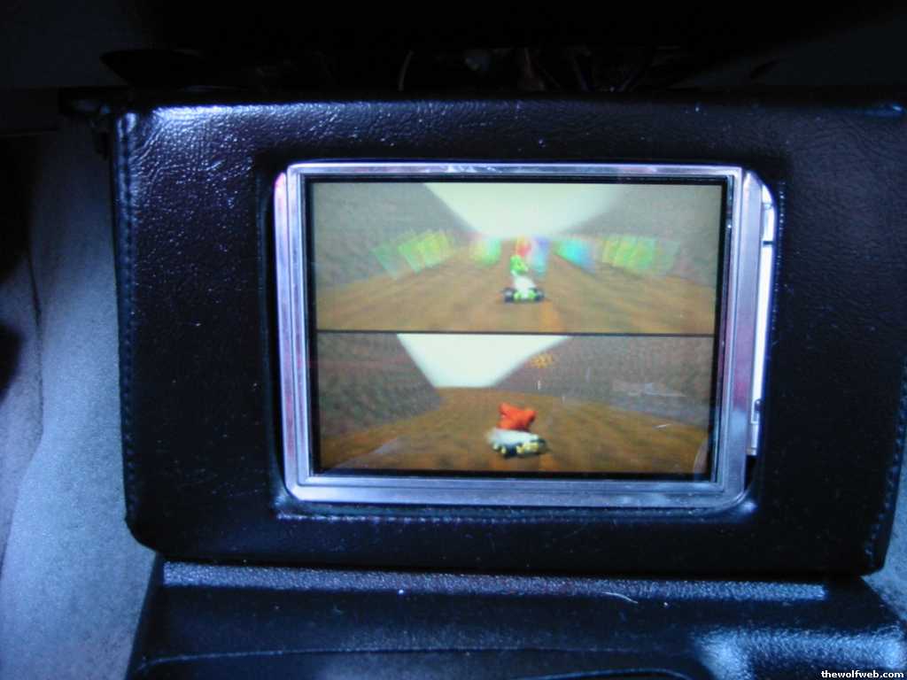

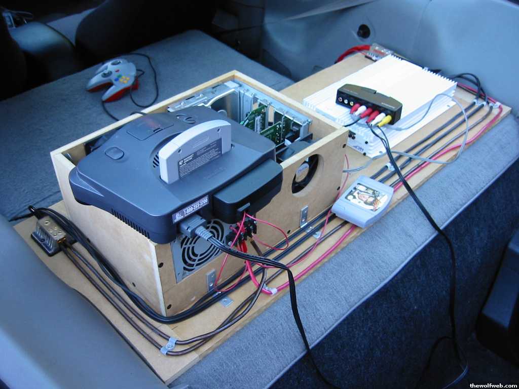

Back when I had more free time, I used to come up with interesting stuff.

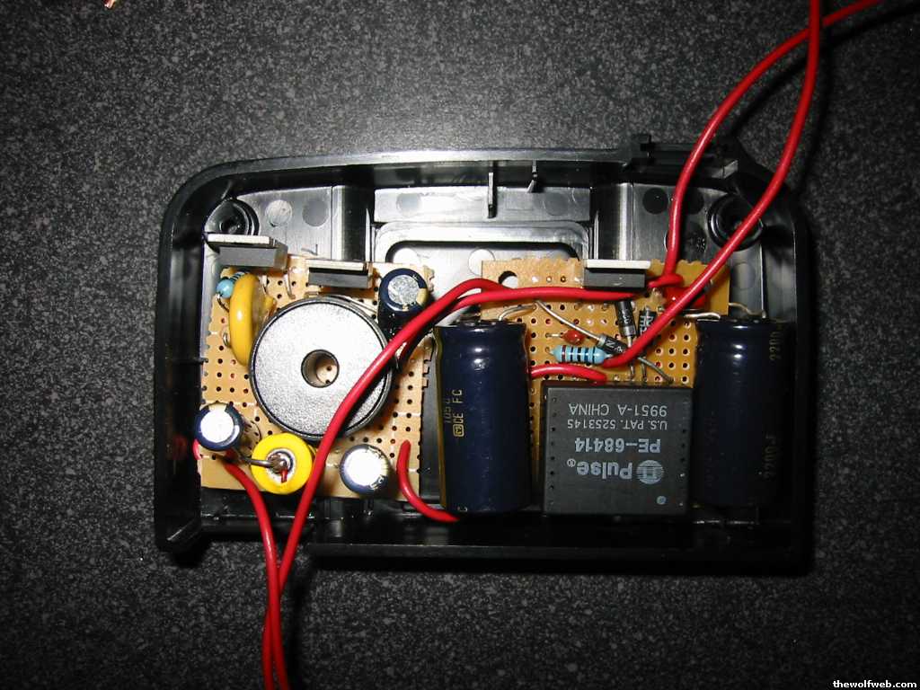

In 2002, I fabbed up a DC-DC converter for an N64 and put it in my car...just for the shit of it.
Btw, that is indeed a computer (also with dc-dc supply) for mp3s. It was a P90 running Win98 lite and a 10gig drive, it had been in there since the summer of '99.

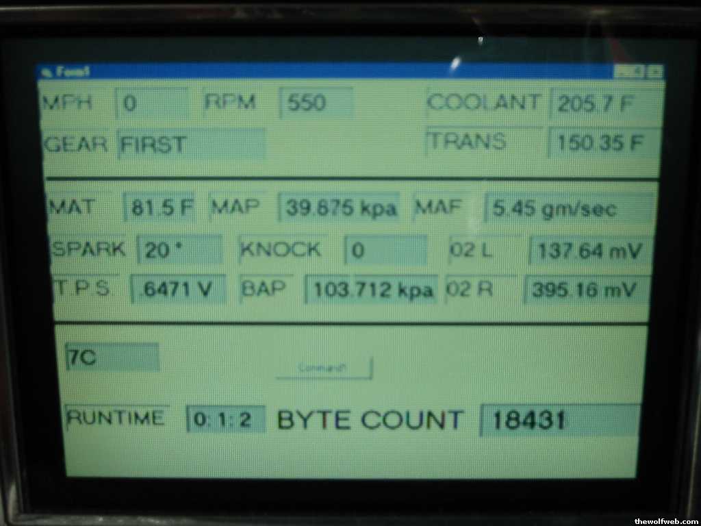

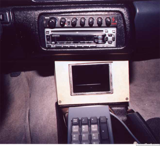

Also did an OBD-ish interface (can't remember what the standard for a 93 camaro was, but it wasn't full obd). Once the car got near 100k miles I could see the knock sensor start registering long before any CEL or loss of power problems could be detected. Good ole optispark.

I'm not familiar with the tankless heaters, but wouldn't the true engineering spirit thing to do be to wire a temp sensor to it so that the fan automatically comes on when it needs to?
^^ Just get a laptop and any of a myriad available connectors and software to get all that data (and more) in a prettier format.
The main reason I had to DIY that was because the '93 Camaro protocol wasn't real OBD (it was some sort of OBDI hybrid) and the connectors and software either didn't exist or was prohibitively expensive for a poor college kid.

Solinari
16957 Posts
oh...I thought that was an in-dash display.
3/29/2009 12:34:04 PM
Fail Boat
3567 Posts
It's a "below dash" display
3/29/2009 1:55:45 PM
evan
27701 Posts
lol @ the numpad
3/29/2009 3:26:50 PM
Fail Boat
3567 Posts
It was a P90, it could barely decode mp3s, so I didn't need any sort of real gui capabilities. I would have gone with linux but at the time it was still in the stage where you had to be a real guru to be efficient in it, and my knowledge of it was pretty limited.
All I needed was a way to display various playlists and to be able to scroll through them. I mapped the keys to macro like functions to do basically any sort of playlist loading, song starting, stopping, pausing, on the fly playlist creating, volume, that I needed.
It worked quite well really, I had it in my car for 4-5 years.
Of course a touchscreen would have been tits, but where it is sitting in my car would have made it generally impractical, and the aforementioned cash flow situation made it a bit prohibitive as well.
