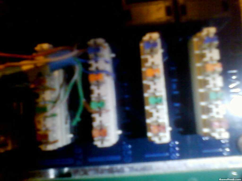

I'm trying to wire in a new connector, and I tried just shoving the wire in to the little slots, and that doesn't work.
Is there a special technique of a special tool you use for these?

It looks like an awful lot like a punchdown block. What application is this for?

Chop
6271 Posts
i'm guessing its CAT5 from the colors
you need a special punch down tool, it looks like this:

This is in my apartment. I'm trying to rewire one of the phone jacks as an ethernet for my PS3.

Definitely a 66/110 punchdown block, then. You'll want a punchdown tool like the one shown above - they generally run less than $20.
http://www.newegg.com/Product/Product.aspx?Item=N82E16899888402
I have this one and it's served me well.

meh, you can get by using a really really small screw driver if that's all you have. just be careful not to break anything

^ I think i've already broken something, but there are multiple empty blocks

The tool is cheap, and it's way, way easier than trying to do it with a screwdriver. Don't try doing it without one.

yeah, you'll either end up stabbing yourself in the hand and/or destroy the punchdown block

But, if anyone can confirm, on a typical cat 5e ethernet cable, only the first 3 and the 6th wires are actually used, correct?

". The only pairs (pins) actually used in xxBaseT are 1&2, 3&6. If you hold a plug with the contacts facing you, and the cable entry at the bottom, the pins go 1,2...7,8 left to right."

^^ for 10/100 you only use two pairs.
If you're going to do gig, you need all 4 pairs.

lulz BobbyDigital beat me to it, gigabit uses all 8 conductors in 4 LVDS pairs
