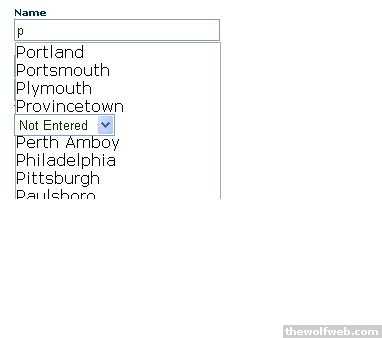

I have successfully implemented an autocomplete list for an item on a form I'm working on. However when the suggestion list is returned, there is a drop down list directly behind the list, and it's showing up on top of my suggestion list. This makes it very difficult to see/select items in the suggestion list.
Anyone have any ideas on how to prevent this from happening? Obviously I want my suggestion list to be on top of any controls that are underneath it. I've been reading about resetting the Z Index of one of my control but I have been unable to do so thus far. Thanks for any ideas

screenshot?
12/18/2008 10:38:00 AM
60972 Posts
12/18/2008 10:53:30 AM

What browser is this happening in? I am assuming IE6 because if you have your CSS setup correctly it will be the only browser with this issue. The easiest and only fix I'm aware of is when your auto complete list is generated and visible on the page, the drop down elements on the page are temporarily hidden.
and as far as setting up your z-index's be sure that all your elements are in the same parent level and have the same positioning (i.e. relative/absolute etc) or it won't work in IE.

"What browser is this happening in? I am assuming IE6 because if you have your CSS setup correctly it will be the only browser with this issue. The easiest and only fix I'm aware of is when your auto complete list is generated and visible on the page, the drop down elements on the page are temporarily hidden."
right on, it's IE6. I thought about hiding the list, but if the user generates the autocomplete list then clicks away from it I think it would miss the unhide and the list would stay hidden (assuming I place the unhide in the selected event for the autocomplete control)

Moving the select box is the only foolproof way to do it.
Like Golovko mentioned, IE6 doesn't properly pass z-indexes when things have different positioning attributes and since your normal HTML code is placed either relative or statically and your autocomplete is probably absolute, you're going to have problems.
I mean, alternatively, you could do what others are suggestings and hide the select box while someone is using the autocomplete, then use JavaScript to detect heights and when the autocomplete returns fewer results than the height necessary to overlap the dropdown. That, combined with onfocus and onblur might get you somewhere.

^^as stein mentioned with onblur. If you set an onblur to call whatever javascript function you have to toggle the visibility/display of the dropdown then if the user clicks any where else on the page it will call that function.
