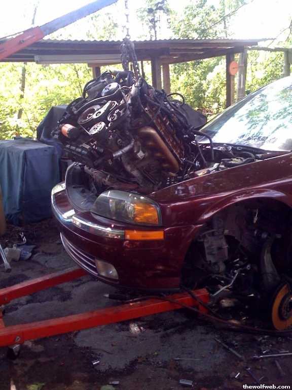

^tell that to ScHpEnXeL, lol. His snapped the other week

^^yup.. broke timing chain. it was because the tensioner came apart, went between the sprocket on the cam and the chain..stretched the chain until it broke--not just a random chain failure or anything
