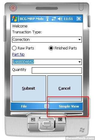

i think pics might help..
is the layout of the app right now. when i scan a barcode whatever is in that barcode should go wherever the cursor is..no parsing or anything during the scanning process.
now when i hit submit, if the first letter of the barcode is a P, i want the P ignored and the rest of the barcode used

[Edited on August 27, 2008 at 8:48 AM. Reason : ignore the red box around simple view]
