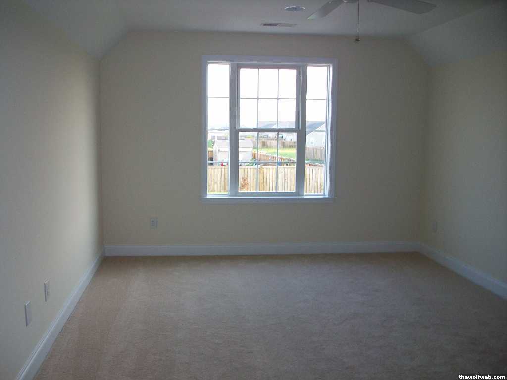

Bonus room over garage will be entertainment room.
Goal: to play PC games on Plasma tv.
I have not purchased a HDMI out card yet.
Consequences: Apparently there will be a little distortion in the proportions. Cannot watch TV and play games at same time.
Question: Does anyone know the best way to set this up for comfort and practicality. It doesn't seem that playing from the couch would be feasible. Also, would it be worth it to have a computer desk on wheels that can be rolled in front of the tv with just a wireless keyboard and mouse and then rolled out of the way in order to watch a movie or entertain people.
What do you think about this. The plasma would be up against the left wall. Its deeper than it looks in the pic.

damn, that's not a very big room, or how it appears to be in the pic. Pretty sure a 42" would be sufficient for that size.

cover that window with a 58" plasma
