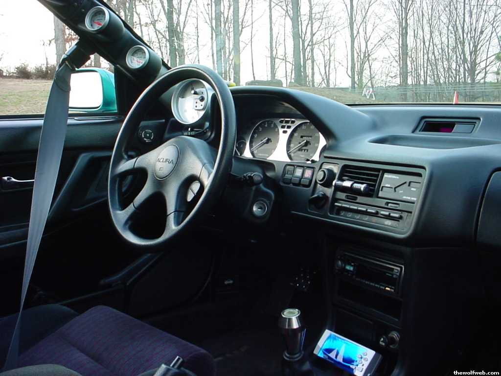

I'm sure you can look online and find what is a good vacuum source off the manifold. Some people tee off the fuel pressure regulator vac source. You need to tap the illumination for the gauge off the parking light circuit.
On turbo applications, AEM recommends that the sensor be at least 36" from the turbo, and BEFORE the cat if you have one. The best bet is to wire everything up, then zip tie the sensor harness (the side that connects to the gauge) somewhere temporarily and take it to a muffler shop to have a bung welded in. After the bung is welded in, have them screw the sensor in and connect it. DO NOT run the engine with the sensor installed but not connected! The heater will not be working on it and you can damage it.
As far as checking knock and cranking up the boost, leave that to the tuner. Some knock sensors on cars can be difficult to interpret due to other noise. I've personally had problems (reading on the gauge did not match the reading from the analog output) with the 0-5v output on the AEM wideband (on two different cars), even running common ground wires. That's why I ended up ditching it and going with Innovate (which has its own set of quirks don't get me wrong) which has more features but is trickier to install.
If you plan to look at your wideband display a decent amount I recommend that you do not mount it in an a-pillar gauge pod. It's too hard to see it and the tach. I have mine mounted on the steering column plastic using an autometer universal cup, so when I look down I can see the tach and the AFR display, but obviously you have to be careful that you mount it properly so you don't obstruct anything important.

"If you plan to look at your wideband display a decent amount I recommend that you do not mount it in an a-pillar gauge pod. It's too hard to see it and the tach. I have mine mounted on the steering column plastic using an autometer universal cup, so when I look down I can see the tach and the AFR display, but obviously you have to be careful that you mount it properly so you don't obstruct anything important."
fucking bingo - i had been thinking of mounting my boost gauge on the steering column for the same reason

IMO a wideband display is almost useless in the A-pillar...
I have seen Integra molded cluster surrounds that have a gauge on either side. Anything molded is a much cleaner look. The autometer universal mounting pod/cup thing looks pretty bad honestly. It just makes the interior look even more busy... I have been trying to reduce the amount of gizmos and bullshit inside the car. Oh well, seeing the wideband is more important than the interior on a motor that is notorious for blowing up.
