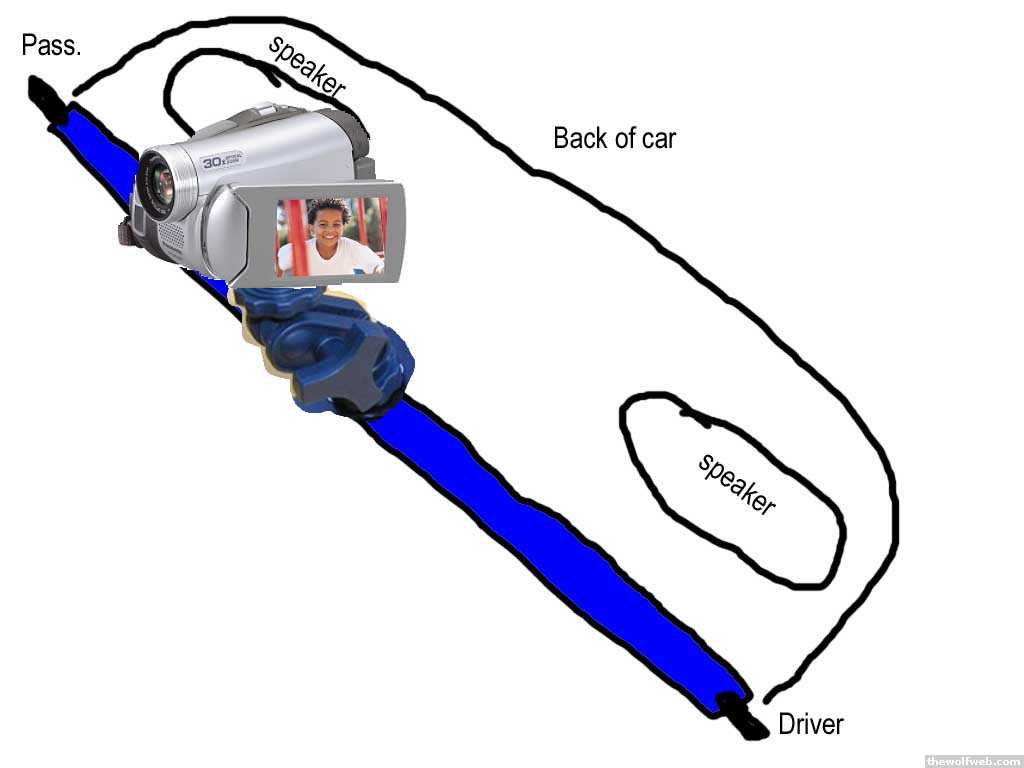

so this is pretty much my setup.
i have maybe 8 inches or so behind the camera (i think around 8). the bar runs across the top of the rear seats.
that blue bar is the bar that goes from the upper seat belt bolts to the other

5/19/2008 10:21:58 PM
Noen
31346 Posts
bolt an anchor plate to the roof and put in another mount that way. just need 2 points of contact and it should be good

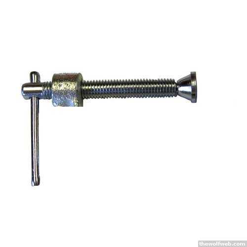

i was thinking something like this from 2 other sides, 3 points of contact... the bottom is screwed in, so from the top 2 sided it will just be pressure, cuz i cant drill/screw into the top of the camera without screwing something up
