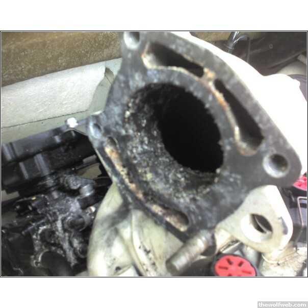

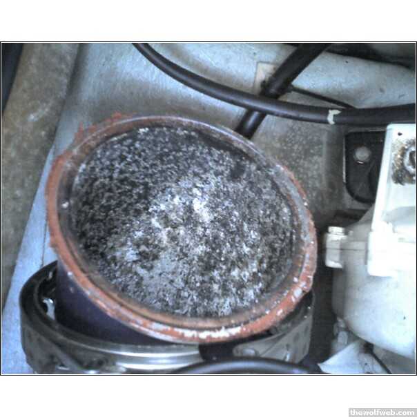

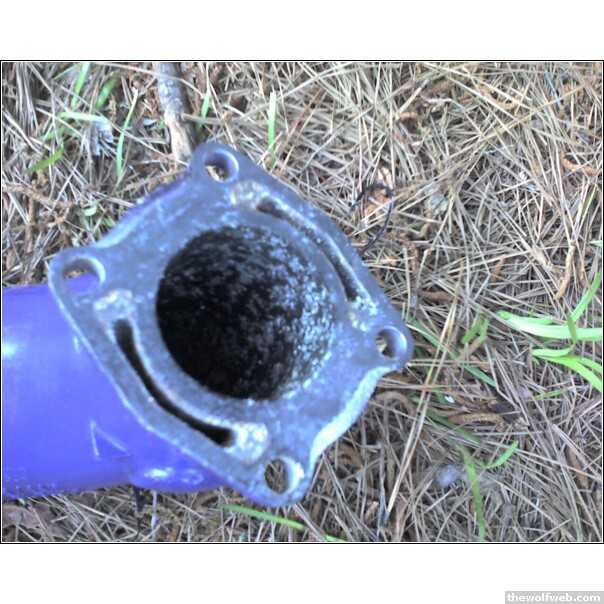

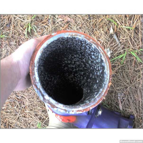

how normal is this? the automotive part says its not a good sign, but the fact that these things run in salt water/sand perhaps is somewhat normal (but a little un-normal)
the first pic is of the flange where exhaust manifold meets whatever
the second is where exhaust manifold meets "muffler"
the last two pics are of the exhaust manifold, i guess thats what it would be.

tawaitt
1443 Posts
looks normal for ocean going skiis

shredder
1262 Posts
Yea that's not too bad, just salt build-up due, needed more flushing, but just make sure there is no bad corrosion. But other than that, I've seen way worse.

BigBlueRam
16852 Posts
yeah, that's not great but not terrible for a 12 year old machine that's spent a lot of time in salt water.

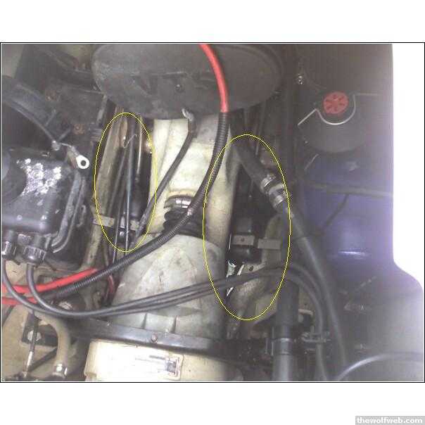

baonest
47902 Posts
the yellow circles are where the oil build up is. under the gas tank there is a small small trail. i think it may have came from there, but i dont know.

5/1/2008 5:42:35 PM
I've always seen oil in that same spot on my Sea Doos. That's one of the spots where those missing nuts and bolts from batteries and whatnot end up after a ride and you always have to fish through the goo to find them. No idea where it comes from, but I wouldn't worry about it. Just hose it out and see if it comes back worse.
I'd go ahead and put in an oil injection blockoff. It's like $15. Those old oil pumps go bad all the time. Nylon gears ftl.
You never did say what it's doing or not doing. Does it turn freely? You should be able to pull that boot back and turn the impeller shaft to see if the engine is locked. Does it turn over? Compression?
Make sure the water passages through the exhaust pipe (those outer channels on the exhaust) are flowing freely. That is your water intake and if they're clogged it'll overheat pretty quickly. Make sure the water exit lines flow freely as well. It should run from the head to a little jet (or pair of jets) at the rear of the ski where the water exits. Just disconnect the water line from the head and try to blow through it.
