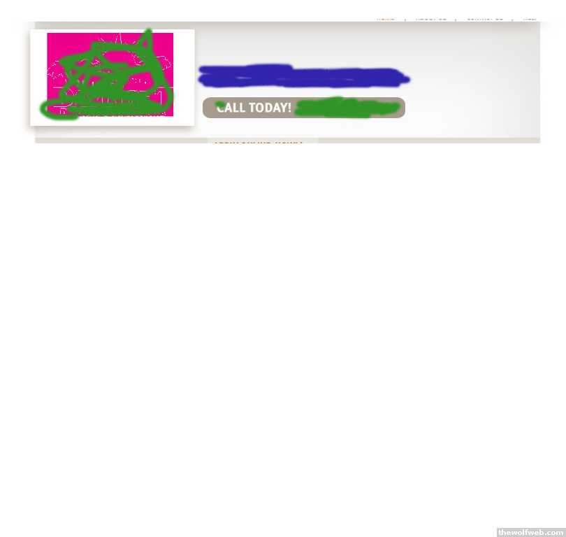

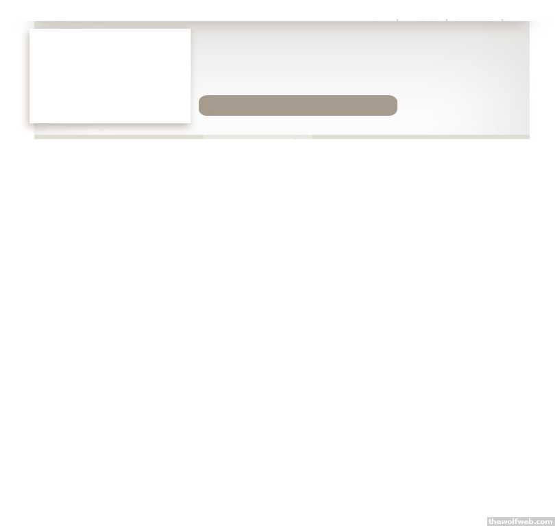

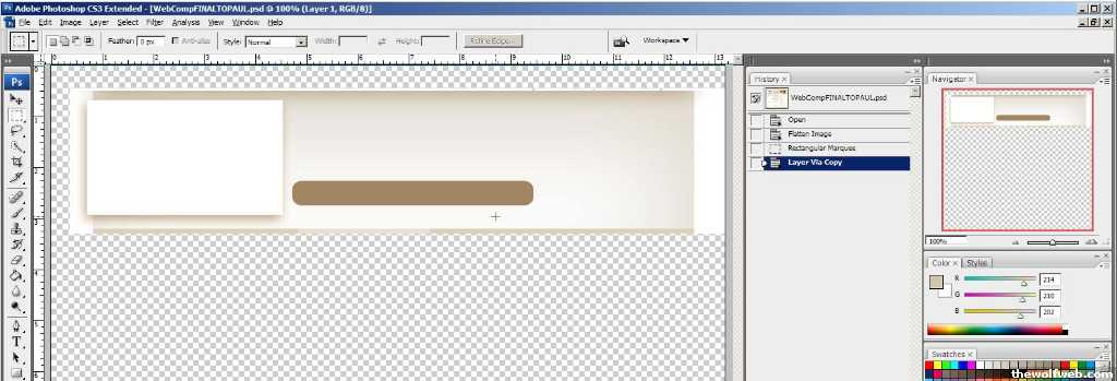

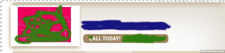

RGB/8 mode with default install of CS3. digital monitors with standard brightness/contrast.
i open up the PSD given to me and the colors used are all tan'ish.
i then save as or save for web to jpg and the colors turn grey??
i.e. i save as jpg and then open up in windows viewer - colors are gray
i open the same jpg back up in photoshop and they're tan.
wtf is going on?
color that should look tan: R216 G213 B204
before you think it's grayscale, if i add text that is colored, that is output close to its color

View | Proof Setup | Monitor RGB
that makes the colors go from tan to gray!
Windows RGB shows it in the same tan colors. I'm afraid it's getting output as Monitor RGB?
now, how can i get it to NOT output as Monitor RGB?
