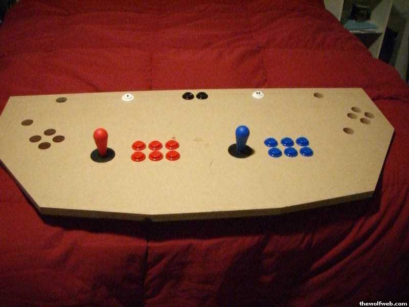

finished cutting the control panel today

I'd recommend adding a 4 way joystick for pacman and such games... gets annoying using the 8 way joysticks with those games...
Or you could build a separate control panel you could mount/unmount easily (with a spinner, trackball, 2x 4 way setups, etc.)
4/17/2007 8:23:32 PM
dubcaps
4765 Posts
i think i will eventually go the 2 control panel route, but for now i really just want a cab that can play nba jam, x-men, and games from that era. either way its been a lot of fun so far, i can't wait to finish though

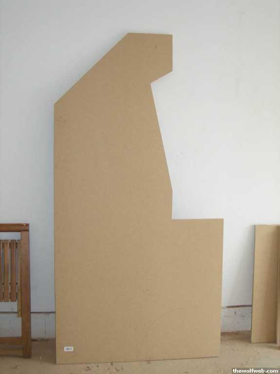

as far as cutting out the side panels what do yall recommend? I was thinking about stacking 2 sheets of MDF on top of each other and clamping them together so they were exactly the same? or is that a bad idea?
4/18/2007 4:16:04 AM
scrager
9481 Posts
cut one pannel. use it as a template to route out the other pannel with a flush trim router bit.
4/18/2007 8:17:04 AM

"cut one pannel. use it as a template to route out the other pannel with a flush trim router bit."
anyone have a router with a flush trim router bit/slot cutting bit i could borrow/rent?
first side done
[Edited on April 18, 2007 at 1:49 PM. Reason : ]
4/18/2007 1:44:55 PM
Noen
31346 Posts
if you dont have a hand router, just trace a line on the next piece and sand it flush where you are a little off
