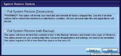

kbbrown3
22312 Posts
I clicked the second option.

plusdelta
1034 Posts
that's a manufacturer-proprietary program. who's your computer's manufacturer?

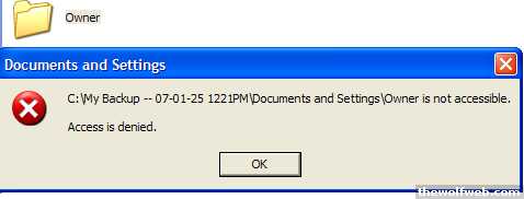

kbbrown3
22312 Posts
^So how do I start changing the rights? Cause the problem I keep getting is:
1/26/2007 11:26:02 AM
60972 Posts
basically you'll right click on a folder, go to properties, then security, then advanced, then owners, then set yourself as the owner as the folder. also be sure to check the box that applies the change to all subfolders.
for more detailed instructions:
http://www.google.com/search?hl=en&rls=SUNA,SUNA:2006-25,SUNA:en&sa=X&oi=spell&resnum=0&ct=result&cd=1&q=is+not+accessible+access+is+denied&spell=1

69 47
151433 Posts
that first screen shot says all hard drive contents will be backed up to the 'C:\My Backup' folder
just change the rights on that folder

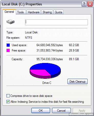

kbbrown3
22312 Posts
Well I wasn't able to change the rights because
is for Windows XP Professional and I have Windows XP Home Edition Service Pack 2
Although I did check the folder I believed the files I'm trying to locate was in and it was empty.
I did an entire system search and the files never turned up in any folder, but if you look at this:
It says the files are still there. I just can't find them.
