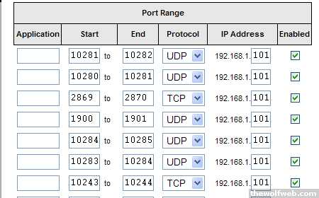

Why can't my XBox 360 see my PC?
I am using a Linksys Router. Here is a screenshot of the port forwarding settings:
My computer is occupying 192.168.1.101, the Xbox 360 is occupying 192.168.1.102
PINGING MY XBOX 360 FROM MY PC DOES THE FOLLOWING:
Request Timed Out.
Request Timed Out.
Request Timed Out.

Do you mean Windows Media Connect? The Zune Software doesn't see my Xbox 360 in the devices section, and I can't ping the Xbox 360 even though it is on the network and able to connect to Xbox live, which leads me to believe this is a firewall problem not a software problem....

^^ The Windows firewall is disabled, the linksys one is a hardware firewall since it's a router...
^ XP Pro SP2

Oh and I just updated my Router firmware to the version it said to have, and nothing...
