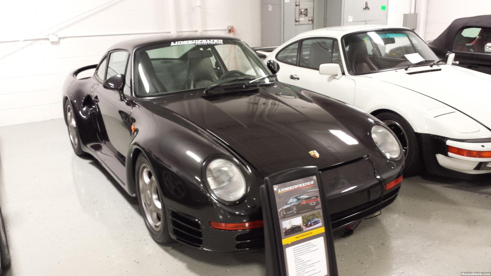

ooooh great topic! here's a picture I took of a 959 at the Ken Lingenfelter collection:
what I like about this car is that it was just so ahead of its time, with the sequential twin turbos (first on a production gasoline engine) and the computer controlled all wheel drive. It looks like a Porsche but it's still different enough to set it apart. It was really fast for an 80s car but probably closer to today's Mustang GT. Now let's talk about the sequential twin turbo system. It was implemented in a different way than all the other sequential systems used from that late 80s-mid 90s era and its different from the two-stage boosting used in diesels today.

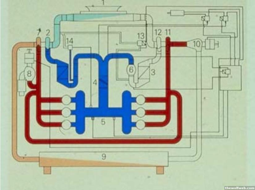

If you look at the right and left sides of the engine, you can see this external-wastegate looking things. Porsche was using an external wastegate on the Porsche 944 at the time, so they used the same type of valve to regulate the turbochargers.
Here's how it worked at low engine speeds. There are two banks with a crossover pipe between them. Exhaust flows through the turbocharger on the left, exiting out the muffler at the bottom of the diagram. Compressed air flows through an intercooler into the throttlebody. The secondary turbo (on the right) has its exhaust flow plugged up by the external-wastegate style valve (right, #10). The compressor side of the secondary turbo looks has a valve controlling its flow (right, #8).
After transition into both turbos, the exhaust flows out of the secondary turbocharger on the right and an external wastegate (left, #8) opens to bleed off exhaust for boost control. Air flows through both turbochargers and both intercoolers in the throttlebody.
I'm not sure exactly how the transition crossover between the two turbos is handled. The valve on the exhaust side of the secondary turbo may be duty controlled. It doesn't look like there is a dedicated "prespool valve" like the Supra 2JZ and Rx-7 13B-REW have. On those engines a valve regulated exhaust flow between the primary and secondary turbos before the secondary turbo came fully online.
The basic control as a hardware system is similar to the Supra 2JZ engine but the individual components are different. The 2JZ used butterfly valves, not poppet vales. The Rx-7 used swing valves. These systems are on a flat 6, an I6, and a inline 2 rotor engine respectively. A lot of it had to do with packaging space. So the Flat 6 has a lot of axial space (towards the center of the car, Y axis parallel to the ground), and used poppet valves. The I6 had more vertical space, perpendicular to the ground on a Z axis. The Rx-7 didn't have fuck-all for space because it's such a small car with front-mid engine configuration. So it used these small swing valves which required complicated actuators to seal gases and still react quickly, using both vacuum and pressure to operate. The Porsche and the Supra used pressure only to operate their valves.
