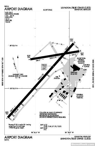

Nighthawk
19725 Posts
Dukes got more flight experience than me, so he is better at filling you in on the details than me.
And your right Duke, I was just trying to illustrate the point that a 3500' runway is far too short for a CRJ-200 with a full complement of passengers and probably a full payload of fuel to make it off the ground or at least enough to clear the treeline. The pictures show some damage to the trees between the crashsite and the runway, meaning likely the plane was getting airborne, but not enough to clear it, the tail or engine struck the tree and then she came down. The cockpit was obviously not destroyed if the police officer was able to pull the first officer from the cabin, so it wasn't a nose strike. If it were a wing striking a tree, the plane would have very likely cartwheeled into the ground, but she landed almost parallel to the centerline, indicating it never changed course.
8/27/2006 9:37:57 PM
bous
11215 Posts
8/27/2006 9:40:38 PM
Nighthawk
19725 Posts
Great illustration Bous and makes it pretty easy to see, they didn't have to go to the other end of the airport to fuck this up, they just had to not pay attention, and instead of taxiing across this runway, to the next one, they stopped at the first one and flew into the trees.
8/27/2006 9:45:47 PM
bous
11215 Posts
I'd love to find out if this was their first time at KLEX or not.
Because if it wasn't, they are fucking retarded.
Otherwise, I can at least see how it's possible to fuck it up.... but I mean looking down the runway it'd seem short. 3500 feet is not that long.
8/27/2006 9:47:40 PM
bous
11215 Posts
http://www.pauljensen.org/KLEX.pdf
OMFG THE RUNWAY WAS ONLY 75' WIDE... 22 is 150' wide.
HOW THE FUCK DID THEY DO THIS?
[Edited on August 27, 2006 at 9:49 PM. Reason : ]
8/27/2006 9:48:37 PM
Nighthawk
19725 Posts
Yea but it was fucking early. Probably their first flight of the day, probably not fully light yet. Maybe the runway illumination fucked with them and they thought it was farther.
8/27/2006 9:49:48 PM
bous
11215 Posts
ya i can understand the distance thing and not thinking about that.
BUT YOU CAN TELL A NARROW RUNWAY... and ALWAYS narrower runways are SHORTER... well almost always.
8/27/2006 9:50:40 PM
Nighthawk
19725 Posts
Just reading, apparently the shorter runway had just been repaved and no lights were operating on it at the time. Of course the sun would have been beginning to come up, so they may have just thought it had been turned off, but it was the third of a dozen flights, so you'd have thought they mighta seen the other planes go off the right runway or somebody in line behind them might have seen them lining up to the wrong one and radio'd it in.
8/27/2006 9:56:32 PM
bous
11215 Posts
"Still, it's tough for that to happen. Tower will call you and say something like "[callsign], winds 240 at 10, cleared for takeoff, runway 22." You immediately have to call back and say "[callsign], cleared for takeoff, 22." it's a required readback that is 2nd nature to ANY pilot. That way, if you misunderstood, the controller can correct you or clarify."
sadly, though, most people from what i've heard (and well, i have much less experience flying than you)... most say "callsign cleared for takeoff" and don't say the runway, only when landing will they say the runway more often (since it's not as important if you're already on the ground)
they would have had to say cleared to cross runway 26, taxi alpha seven to runway hold short 22 or some variation.
these motherfuckers must have not been thinking and that pisses me off. I want to know their BAC from autopsy.
