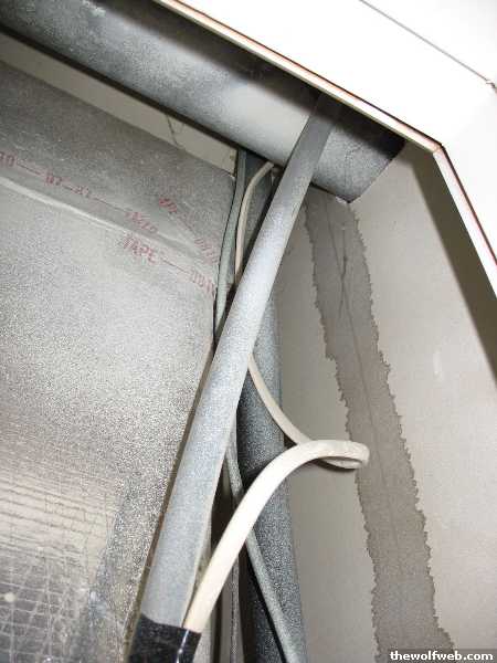

Im not sure -- the water heater is on the right side of the hallway, the air conditioner is on the left side directly across from it. Both floorings are soaked inside and the entire hallway between the two doors are soaked completely now as well. The dripping is definately coming from inside the AC room -- and I just now see on the wall where its coming from the ceiling in there -- Ill take a picture and post it in a minute -- also in the water heater room, I hear dripping as well, but I dont see any signs of where thats coming from -- back in a minute with pictures

From the minimum amount of information you've given, I'm guessing that the drain pan under your air handler is clogged up and not draining. Check! There should be a pan inside the airhandler under the A-coil. Is it full of water? Is there a secondary catch pan under the airhandler? If so (code says it should be there) is it draining or is it full of water? Check for cracked pipes. If either the pan drain pipes are leaking or the pans aren't draining, TURN OFF YOUR AC. If the pans are clogged, you can sometime clear the drains with a wet/dry vac if you have or can borrow one. If a pipe is cracked, it will need to be fixed. You can do it yourself for real cheap or just make your matainence people do it. Since you mentioned the water heater, you should check that too. Just look for signs that point to leaking water. Good luck!

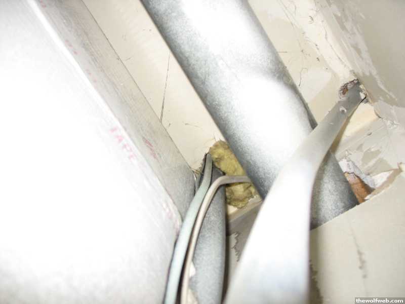

I just saw your pics. It looks like you have some sort of water-to-air heatpump. I think either the input or output waterline is leaking. I'd turn off the AC. That may stop the heatpump from circulating water and stop the leaking. If those lines run up under your roof, a roofer might have hit one with a nail gun. Not much you can do yourself to fix it unless you're a plumber or an HVAC guy.

So its definately coming from a pipe that goes into the ceiling -- these are pics from inside the AC room. I can also hear dripping and see water from behind the water heater (cant see the drip, but hear it and see the water standing back there)
I think they fucked something up with the roofing earlier, and its probably flooding the room above mine in which no one lives -- just called the maintenance # again -- the guy is frustrated as hell that he cant get a single person to answer an emergence phone call -- this is bullshit
The last picture is where you can see the drip coming from, thats a tube/pipe that runs into the ceiling in the AC room

little bit of clarity, the largest pipe/tube coming from the hole where the water is dripping in, that tube/pipe does go into my AC unit at the bottom of the unit.

I'm trying to figure out what the pipe is. Is it labled? Nevertheless, water isn't leaking up, so the leak is above you. The question is, is it your stuff leaking or someone elses. Did you try turning off your AC? If so, did it have a noticeable effect on the flow of the leaking water?

Final verdict -- the apt. upstairs has been empty since we moved in, apparantly their toilet line had a tiny leak/crack, and has been dripping the entire time up there -- just recently did it get bad enough that it started dripping through the floor, also looks like I may have a little ceiling damage from it in the bathroom as well that I hadnt noticed before (dont usually look up in the corners in there)
They've shut off the toilet and dried it up as best they can upstairs, and will be back in the AM to take care of my room.
