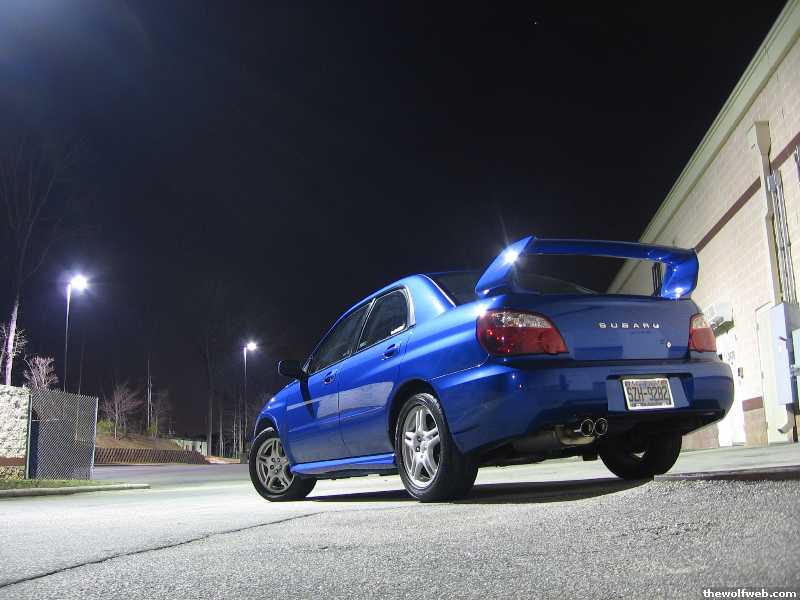

69
15861 Posts
still havent said what kind of car it is
7/10/2006 10:00:40 AM
xvang
3468 Posts
[Edited on July 10, 2006 at 3:12 PM. Reason : pic]
7/10/2006 3:11:38 PM
