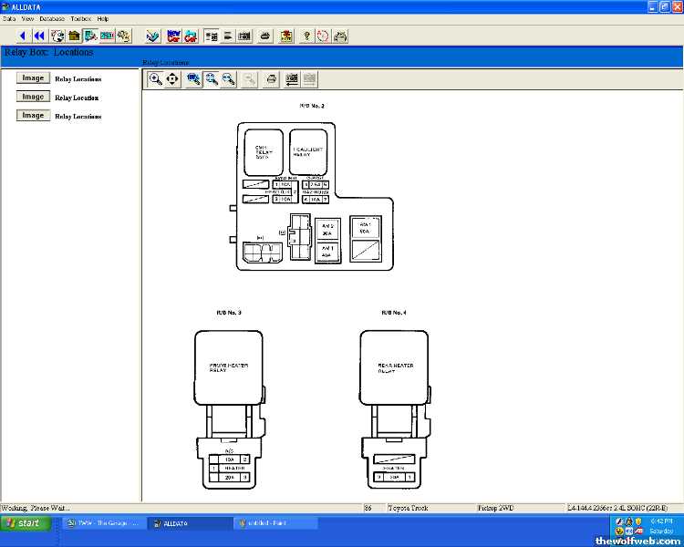

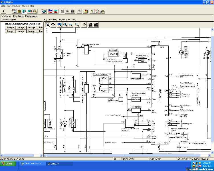

69
15861 Posts
i have the diagrams, but the toyota diagrams include a lot of systems and they are on several pages, i tried to cut and paste into paint, but it was hard to read, if you need me to , i can just print out whatever you need and you can swing by sometime and pick it up. the tail, turn, horn, brake, and cruise control circuits are all on one diagram, the ecm is another huge one by itself

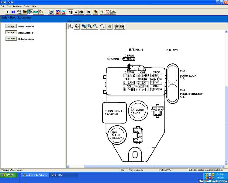

aikenis02
63 Posts
Do you know where I could get a legend for the fuses? Mine doesn't have one on the cover anymore for some reason. Under the hood or the kickpanel. I was wandering if it was something like that. A guy on nc4x4.com told me to jump the fuel pump so it would stay on all the time so I could make sure it was an electrical issue.

69
15861 Posts
and which relay did you replace? the main efi relay in the fuse box, or the fuel pump relay behind the passenger kickpanel by the pcm?

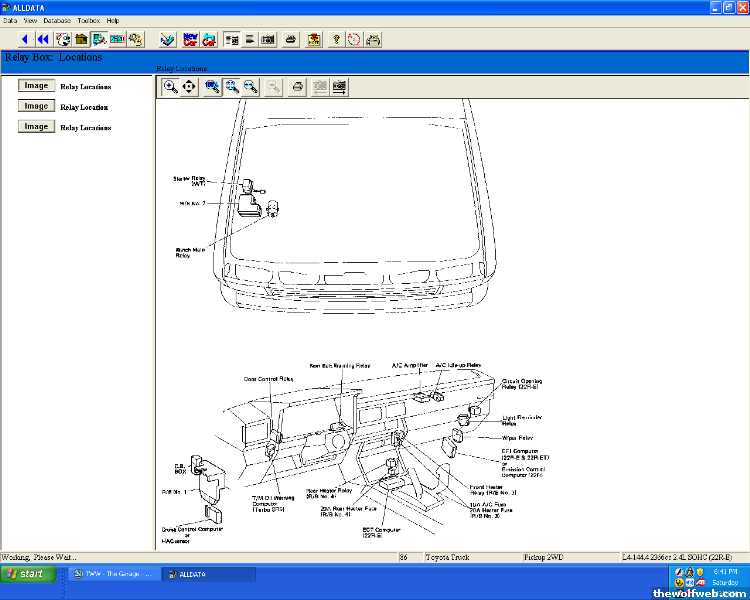

Dude I didn't see any fuses or relays. I called Fred Anderson and the guy there said the relay was under the hood. But I don't have a legend telling me what is what. Do you have the legend for the one under the hood like the one you had for the one in the left kickpanel?

69
15861 Posts
check on the passeger side inner fender then, it will probably be near the firewall, but i'm about 99% sure its under the dash by the kickpanel on the passenger side near the pcm though, its definately not in the underhood fuse block, its on a connector by itself

aikenis02
63 Posts
I just looked harder around the pcm and found the circuit open relay tucked up in the fender. Is this what you were talking about?
6/3/2006 7:59:24 PM
69
15861 Posts
thats the one

15861 Posts
how many terminals did it have?
one comes from the efi main relay, hot when the ignition is on, one goes to the fuel pump, one comes from the start position on the ignition switch, and there is one or two grounds depending on if there are four or five prongs

aikenis02
63 Posts
It had five. Yea I have that schematic in the repair manuel. Advance didn't have one so I guess I am going to have to go to the dealer. I worked on the drum brakes today. Somebody put the adjuster on backwards on the right side. Other than that everything looked okay. I still don't have much pedal with the truck off. It should get rock hard like any other car right? That's as far as I got today. More to come later.
